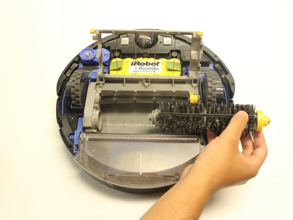

    • Flip the Roomba upside down. Using the Phillips #0 screwdriver, carefully remove the 5 mm screw holding the brush in place.
  2. iRobot Roomba 595 Pet Series Main Brush Replacement: crwdns2935265:02crwdnd2935265:01crwdnd2935265:01crwdne2935265:0
    • Gently pull the brush up and remove it from the device.
  3. iRobot Roomba 595 Pet Series Main Brush Replacement, Main Brush: crwdns2935265:03crwdnd2935265:01crwdnd2935265:02crwdne2935265:0 iRobot Roomba 595 Pet Series Main Brush Replacement, Main Brush: crwdns2935265:03crwdnd2935265:02crwdnd2935265:02crwdne2935265:0
    • Remove the four 10mm screws with a Phillips #1 screwdriver. Gently lift off the external covering for the Roomba's underside.
  4. iRobot Roomba 595 Pet Series Main Brush Replacement: crwdns2935265:04crwdnd2935265:01crwdnd2935265:03crwdne2935265:0 iRobot Roomba 595 Pet Series Main Brush Replacement: crwdns2935265:04crwdnd2935265:02crwdnd2935265:03crwdne2935265:0 iRobot Roomba 595 Pet Series Main Brush Replacement: crwdns2935265:04crwdnd2935265:03crwdnd2935265:03crwdne2935265:0
    • Press lightly on the yellow tabs and lift the cage cover containing the brush.
  5. iRobot Roomba 595 Pet Series Main Brush Replacement: crwdns2935265:05crwdnd2935265:01crwdnd2935265:02crwdne2935265:0 iRobot Roomba 595 Pet Series Main Brush Replacement: crwdns2935265:05crwdnd2935265:02crwdnd2935265:02crwdne2935265:0
    • Lift the brush from the right side and slide it from its container within the Roomba.
