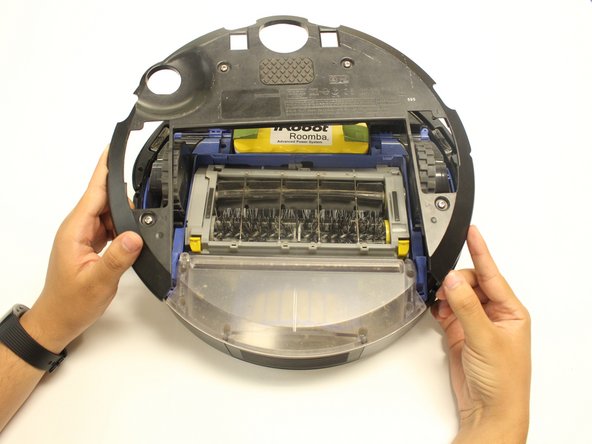

    • Unscrew the four 10mm screws on the underside of the Roomba with a Phillips #1 screwdriver.
    • Lift the external underside cover accordingly.

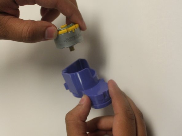

    • Remove the motor from the blue casing.
