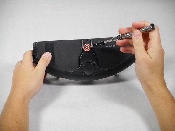

      • Press the black circular button on the back end of the Roomba and pull the bin out towards you to remove the vacuum bin.
    2. iRobot Roomba 560 Fan Replacement: crwdns2935265:02crwdnd2935265:01crwdnd2935265:02crwdne2935265:0 iRobot Roomba 560 Fan Replacement: crwdns2935265:02crwdnd2935265:02crwdnd2935265:02crwdne2935265:0

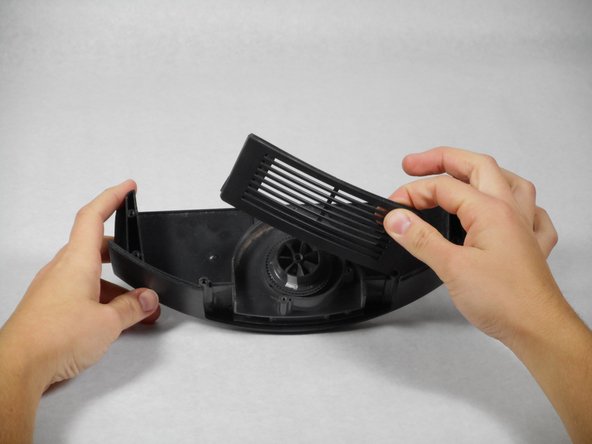

      • Lay the vacuum bin down and remove the six 15 mm screws around the outside of the vacuum bin using the Phillips JIS #1 driver.
      • Remove the top of the vacuum bin by pulling it straight up.
      • The bin is composed of two parts (the clear top casing and the red bottom filter). To avoid a mess, be careful to not let these two pieces detach, unless over a trash bin.

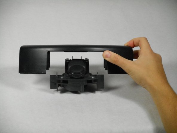

      • Remove the three 10 mm screws that surround the fan using the Phillips JIS #1 driver.
      • Remove the casing that surrounds the fan by pulling it straight up.
      • The casing is composed of 2 parts (the large top casing, and a small air filter). If these parts detach, they are very easy to put back together. Do not lose the air filter.
