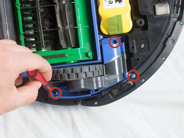

    1. iRobot Roomba 551 Side Wheel Replacement, Side Wheel: crwdns2935265:07crwdnd2935265:01crwdnd2935265:03crwdne2935265:0 iRobot Roomba 551 Side Wheel Replacement, Side Wheel: crwdns2935265:07crwdnd2935265:02crwdnd2935265:03crwdne2935265:0 iRobot Roomba 551 Side Wheel Replacement, Side Wheel: crwdns2935265:07crwdnd2935265:03crwdnd2935265:03crwdne2935265:0
      • Find the blue wheel at the bottom of the Roomba, and unscrew the three captive screws holding it in place using a Phillips #1 screwdriver.

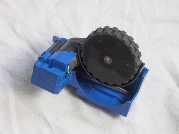

    2. iRobot Roomba 551 Side Wheel Replacement: crwdns2935265:08crwdnd2935265:01crwdnd2935265:02crwdne2935265:0 iRobot Roomba 551 Side Wheel Replacement: crwdns2935265:08crwdnd2935265:02crwdnd2935265:02crwdne2935265:0
      • Gently lift the wheel to remove.
