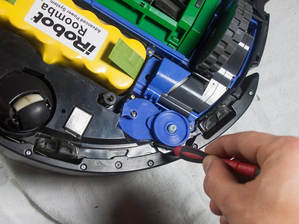

  7. iRobot Roomba 551 Side Brush Motor Replacement, Side Brush Motor: crwdns2935265:07crwdnd2935265:01crwdnd2935265:03crwdne2935265:0 iRobot Roomba 551 Side Brush Motor Replacement, Side Brush Motor: crwdns2935265:07crwdnd2935265:02crwdnd2935265:03crwdne2935265:0 iRobot Roomba 551 Side Brush Motor Replacement, Side Brush Motor: crwdns2935265:07crwdnd2935265:03crwdnd2935265:03crwdne2935265:0
    • Use a Phillips #1 screwdriver to remove the two captive mounting screws on the side wheel motor assembly.
  8. iRobot Roomba 551 Side Brush Motor Replacement: crwdns2935265:08crwdnd2935265:01crwdnd2935265:01crwdne2935265:0
    • Gently pull on motor assembly to remove.
