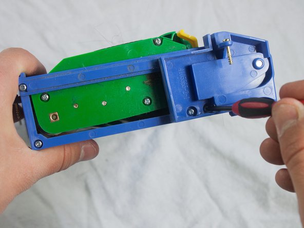

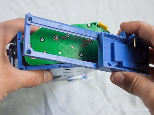

  10. iRobot Roomba 551 Main Brush Motor Replacement, Main Brush Motor: crwdns2935265:010crwdnd2935265:01crwdnd2935265:03crwdne2935265:0 iRobot Roomba 551 Main Brush Motor Replacement, Main Brush Motor: crwdns2935265:010crwdnd2935265:02crwdnd2935265:03crwdne2935265:0 iRobot Roomba 551 Main Brush Motor Replacement, Main Brush Motor: crwdns2935265:010crwdnd2935265:03crwdnd2935265:03crwdne2935265:0
    • Use a Phillips #1 screwdriver to remove the 9.5mm screws from the side of the brush case, and pull to detach.
    • Repeat for the opposite side of the brush case.

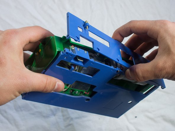

  11. iRobot Roomba 551 Main Brush Motor Replacement: crwdns2935265:011crwdnd2935265:01crwdnd2935265:03crwdne2935265:0 iRobot Roomba 551 Main Brush Motor Replacement: crwdns2935265:011crwdnd2935265:02crwdnd2935265:03crwdne2935265:0 iRobot Roomba 551 Main Brush Motor Replacement: crwdns2935265:011crwdnd2935265:03crwdnd2935265:03crwdne2935265:0
    • Use a Phillips #1 screwdriver to remove the three 5.0mm screws from the back of the brush case.
    • Pull off the back of the brush case.

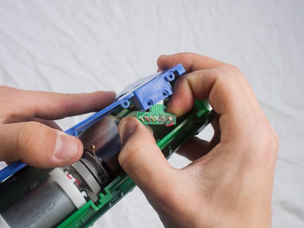

    • Use a Phillips #1 screwdriver to remove the two 1.5mm screws securing the chip in place.
    • Remove the chip from its housing in the blue brush case.

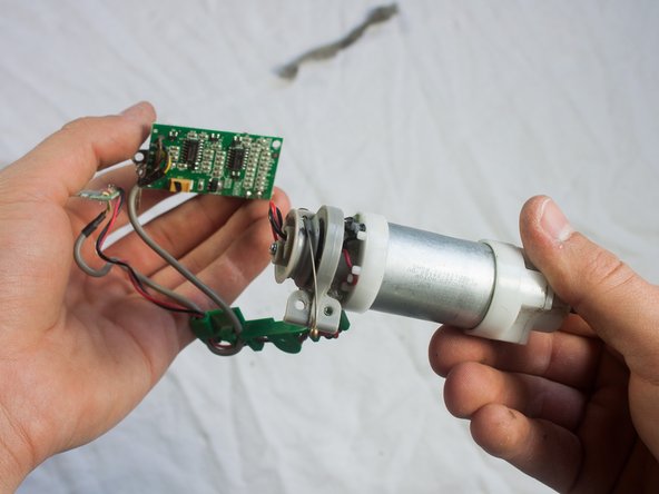

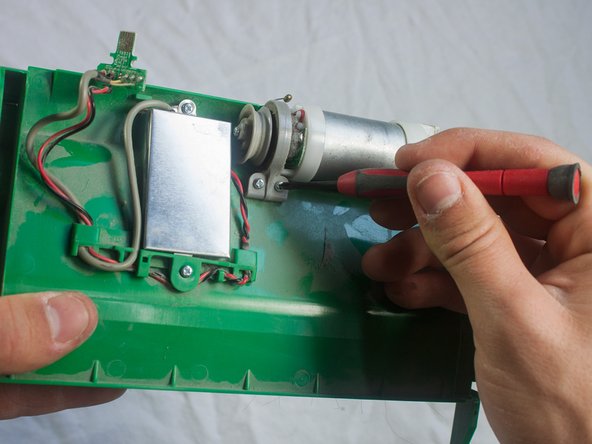

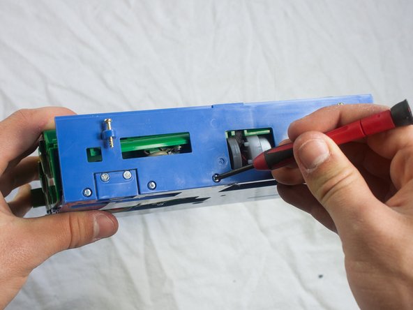

    • Use a Phillips #1 screwdriver to remove the two 5.5mm screws securing the motor in place.
  14. iRobot Roomba 551 Main Brush Motor Replacement: crwdns2935265:014crwdnd2935265:01crwdnd2935265:02crwdne2935265:0 iRobot Roomba 551 Main Brush Motor Replacement: crwdns2935265:014crwdnd2935265:02crwdnd2935265:02crwdne2935265:0
    • Use a Phillips #1 screwdriver to remove the two 4.5mm screws on the top and bottom of the metal plate.
    • Pull out the motor and metal covering.

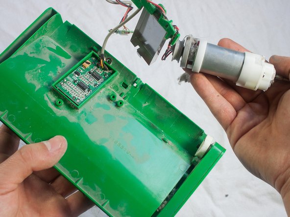

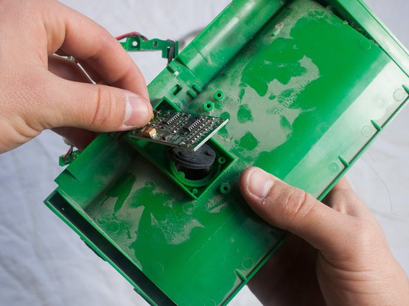

  15. iRobot Roomba 551 Main Brush Motor Replacement: crwdns2935265:015crwdnd2935265:01crwdnd2935265:03crwdne2935265:0 iRobot Roomba 551 Main Brush Motor Replacement: crwdns2935265:015crwdnd2935265:02crwdnd2935265:03crwdne2935265:0 iRobot Roomba 551 Main Brush Motor Replacement: crwdns2935265:015crwdnd2935265:03crwdnd2935265:03crwdne2935265:0
    • Use a Phillips #1 screwdriver to remove the two 3.5mm screws on the corners of the circuit board.
    • Gently pull out the circuit board.
