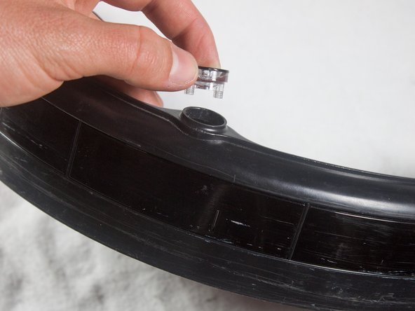

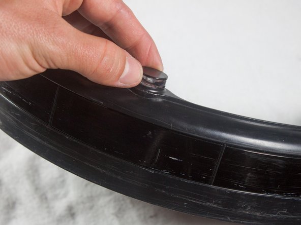

      • Place your Roomba upside-down on a hard surface.
    2. iRobot Roomba 551 Bumper Sensor Replacement: crwdns2935265:02crwdnd2935265:01crwdnd2935265:01crwdne2935265:0
      • While holding the side brush in place, use a Phillips #1 screwdriver to remove the 4.5mm screw from the center of the brush.
    3. iRobot Roomba 551 Bumper Sensor Replacement: crwdns2935265:03crwdnd2935265:01crwdnd2935265:01crwdne2935265:0
      • Gently pull upwards on the brush to remove it.

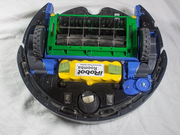

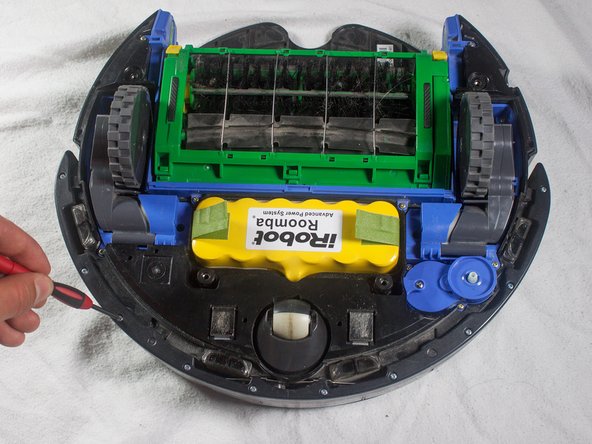

    1. iRobot Roomba 551 Bumper Sensor Replacement, Bottom Plate: crwdns2935265:04crwdnd2935265:01crwdnd2935265:01crwdne2935265:0
      • Rotate the Roomba upside-down so the bottom is facing towards you.
    2. iRobot Roomba 551 Bumper Sensor Replacement: crwdns2935265:05crwdnd2935265:01crwdnd2935265:02crwdne2935265:0 iRobot Roomba 551 Bumper Sensor Replacement: crwdns2935265:05crwdnd2935265:02crwdnd2935265:02crwdne2935265:0
      • Using a Phillips #2 screwdriver, remove the captive screws that hold the bottom plate in place.
    3. iRobot Roomba 551 Bumper Sensor Replacement: crwdns2935265:06crwdnd2935265:01crwdnd2935265:01crwdne2935265:0
      • Carefully lift the bottom plate.
      • The battery is only secured in place by the bottom plate, and may fall out once the bottom plate is removed.
