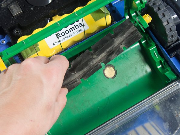

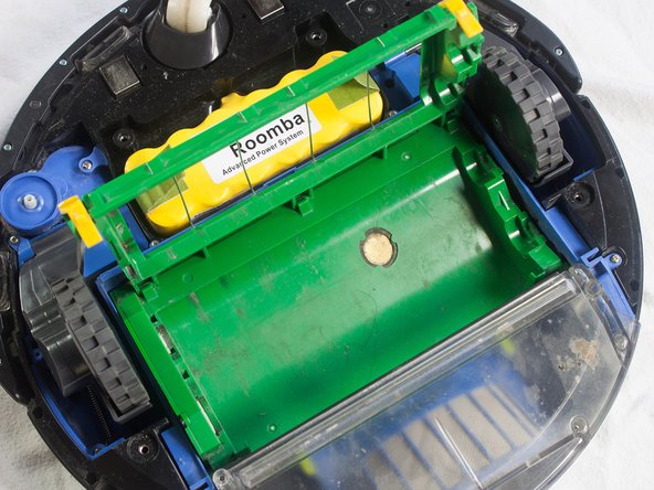

  7. iRobot Roomba 551 Brushes Replacement, Brushes: crwdns2935265:07crwdnd2935265:01crwdnd2935265:02crwdne2935265:0 iRobot Roomba 551 Brushes Replacement, Brushes: crwdns2935265:07crwdnd2935265:02crwdnd2935265:02crwdne2935265:0
    • Pinch the yellow tabs on the sides of the brush cage and lift up to open.
  8. iRobot Roomba 551 Brushes Replacement: crwdns2935265:08crwdnd2935265:01crwdnd2935265:03crwdne2935265:0 iRobot Roomba 551 Brushes Replacement: crwdns2935265:08crwdnd2935265:02crwdnd2935265:03crwdne2935265:0 iRobot Roomba 551 Brushes Replacement: crwdns2935265:08crwdnd2935265:03crwdnd2935265:03crwdne2935265:0
    • Grab each brush and lift upwards to remove.

Should be no need to remove the back plate. Just open the brush cage and lift out the brushes
Gunnar Nybraten - crwdns2934203:0crwdne2934203:0
I did all that, bought a new brush cage and it is still announcing error 2-clean brushes.
