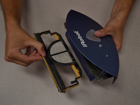

    • Make sure the Roomba is turned off, or electric shock can occur.
    • Place the Roomba on a flat surface with the top side facing you.
    • The three buttons on the control panel and the word "iRobot" should be facing you.
    • Locate the gumdrop shaped push button on the top of the roomba, directly below the word "iRobot."
  2. iRobot Roomba 4160 Dust Filter Replacement: crwdns2935265:02crwdnd2935265:01crwdnd2935265:02crwdne2935265:0 iRobot Roomba 4160 Dust Filter Replacement: crwdns2935265:02crwdnd2935265:02crwdnd2935265:02crwdne2935265:0
    • To open the dust bin, grasp the bumper of the Roomba with one hand while using your other hand and thumb to hold the dust bin and press the gumdrop shaped button.
    • While pressing the button, pull the dust bin away from the Roomba until it is free of the Roomba body.
  3. iRobot Roomba 4160 Dust Filter Replacement: crwdns2935265:03crwdnd2935265:01crwdnd2935265:01crwdne2935265:0
    • With the dust bin removed, the inside of the dust bin should be visible. A green circuit board should be visible in the back of the dust bin.
    • Avoid spreading the loose dust around or breathing it, to avoid getting sick.
    • Locate the yellow plastic filter frame at the front of the dust bin. This is a yellow plastic rectangle with black text and arrows in it, directly above a blue rubber flap.
  4. iRobot Roomba 4160 Dust Filter Replacement: crwdns2935265:04crwdnd2935265:01crwdnd2935265:02crwdne2935265:0 iRobot Roomba 4160 Dust Filter Replacement: crwdns2935265:04crwdnd2935265:02crwdnd2935265:02crwdne2935265:0
    • To remove the filer frame, grasp the yellow plastic rectangle between your thumb and index finger while holding the opposite side of the dust bin with the other hand.
    • Pull the yellow plastic frame away from the dust bin.
    • The dust filter should be visible in the center of the yellow plastic frame.
