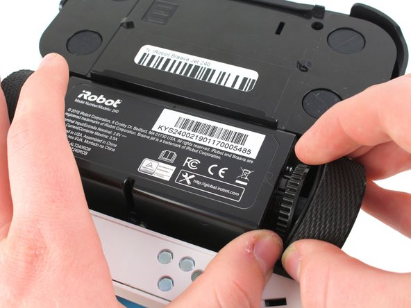

  6. iRobot Braava Jet 240 Wheel Replacement, Wheel: crwdns2935265:06crwdnd2935265:01crwdnd2935265:02crwdne2935265:0 iRobot Braava Jet 240 Wheel Replacement, Wheel: crwdns2935265:06crwdnd2935265:02crwdnd2935265:02crwdne2935265:0
    • Using your thumbs, first push back the motor assembly, then push up.

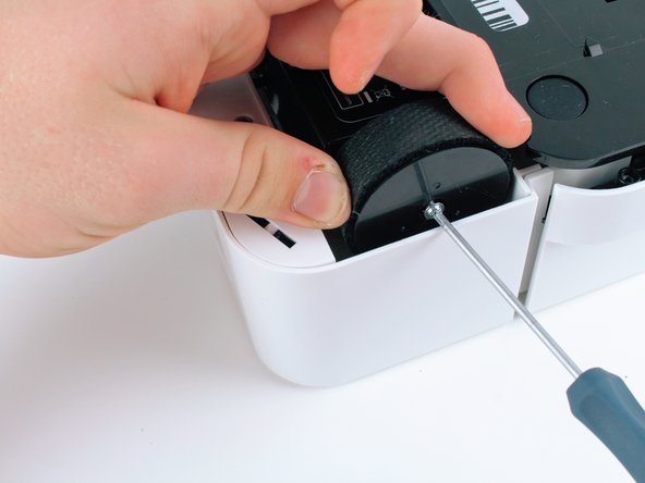

  7. iRobot Braava Jet 240 Wheel Replacement: crwdns2935265:07crwdnd2935265:01crwdnd2935265:02crwdne2935265:0 iRobot Braava Jet 240 Wheel Replacement: crwdns2935265:07crwdnd2935265:02crwdnd2935265:02crwdne2935265:0
    • Remove the 11.55 mm screws in the middle of both wheels using the Phillips #1 screwdriver.

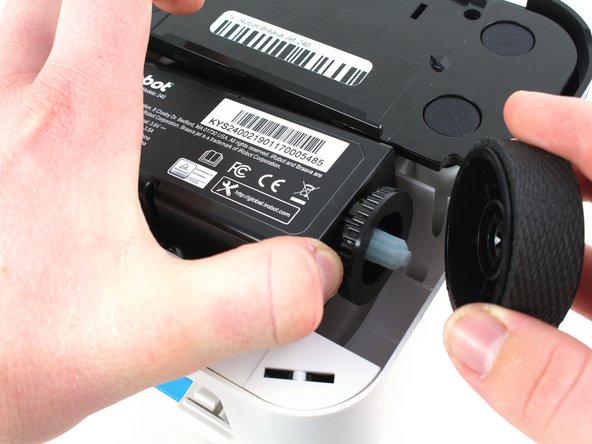

  8. iRobot Braava Jet 240 Wheel Replacement: crwdns2935265:08crwdnd2935265:01crwdnd2935265:03crwdne2935265:0 iRobot Braava Jet 240 Wheel Replacement: crwdns2935265:08crwdnd2935265:02crwdnd2935265:03crwdne2935265:0 iRobot Braava Jet 240 Wheel Replacement: crwdns2935265:08crwdnd2935265:03crwdnd2935265:03crwdne2935265:0
    • Pull the wheel off from the axel, pulling from the top end first so it can slide out at an angle.
    • It will be easier to remove the wheels if the motor assembly is tilted so that the wheel that you are removing is elevated.
