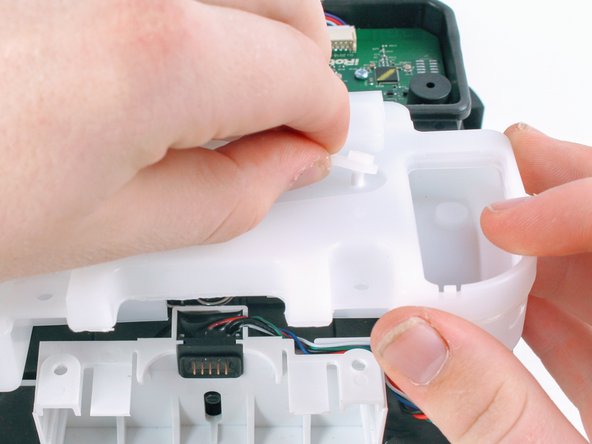

    2. iRobot Braava Jet 240 Tank Replacement: crwdns2935265:013crwdnd2935265:01crwdnd2935265:03crwdne2935265:0 iRobot Braava Jet 240 Tank Replacement: crwdns2935265:013crwdnd2935265:02crwdnd2935265:03crwdne2935265:0 iRobot Braava Jet 240 Tank Replacement: crwdns2935265:013crwdnd2935265:03crwdnd2935265:03crwdne2935265:0
      • Pull up on the L - shaped plastic piece and remove it from the tank assembly.

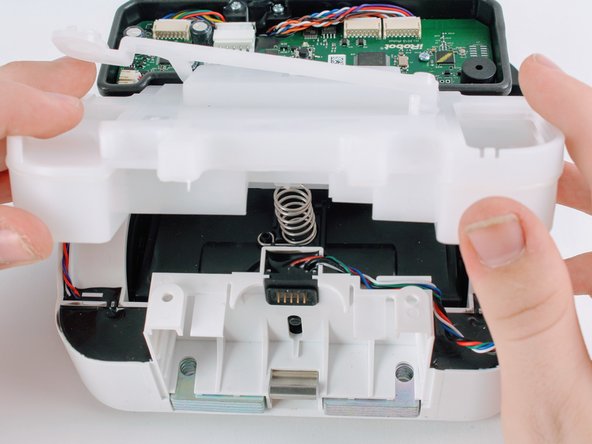

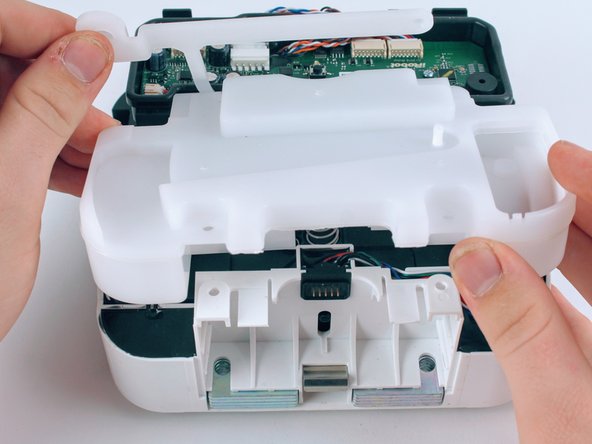

    3. iRobot Braava Jet 240 Tank Replacement: crwdns2935265:014crwdnd2935265:01crwdnd2935265:02crwdne2935265:0 iRobot Braava Jet 240 Tank Replacement: crwdns2935265:014crwdnd2935265:02crwdnd2935265:02crwdne2935265:0
      • Lift the tank up and away from the device.
      • Don't pull the tank too hard because it is still attached to the water tube at the back.

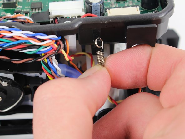

    4. iRobot Braava Jet 240 Tank Replacement: crwdns2935265:015crwdnd2935265:01crwdnd2935265:03crwdne2935265:0 iRobot Braava Jet 240 Tank Replacement: crwdns2935265:015crwdnd2935265:02crwdnd2935265:03crwdne2935265:0 iRobot Braava Jet 240 Tank Replacement: crwdns2935265:015crwdnd2935265:03crwdnd2935265:03crwdne2935265:0
      • First pull up, then pull down on the spring to detach it from the hooks.

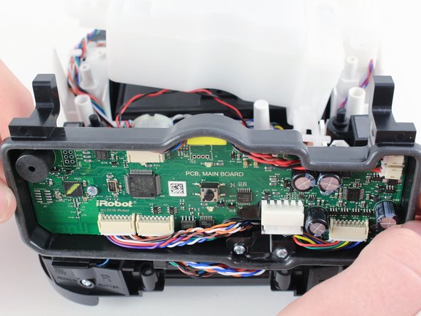

    5. iRobot Braava Jet 240 Tank Replacement, Remove the motherboard case: crwdns2935265:016crwdnd2935265:01crwdnd2935265:02crwdne2935265:0 iRobot Braava Jet 240 Tank Replacement, Remove the motherboard case: crwdns2935265:016crwdnd2935265:02crwdnd2935265:02crwdne2935265:0
      • Lift up on the motherboard case to remove it from the device. This will expose the water tube that is attached to the tank.

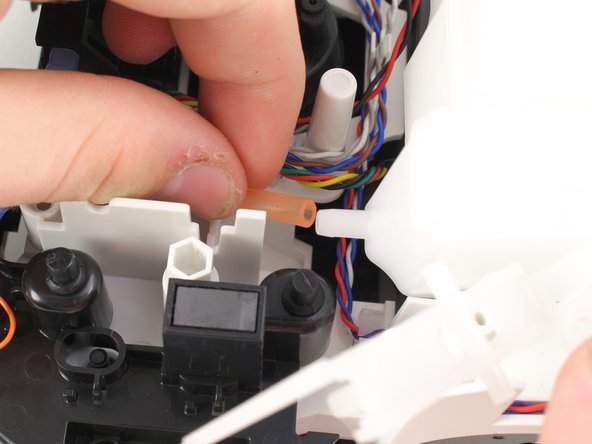

    6. iRobot Braava Jet 240 Tank Replacement: crwdns2935265:017crwdnd2935265:01crwdnd2935265:02crwdne2935265:0 iRobot Braava Jet 240 Tank Replacement: crwdns2935265:017crwdnd2935265:02crwdnd2935265:02crwdne2935265:0
      • Pull the tubing off of the tank connector.

Good guide. I would suggest doing steps 13-16 before step 12 and a small hook (bent wire, staple or the like) makes reattaching the spring (step 15) a lot easier. Otherwise, perfect.
