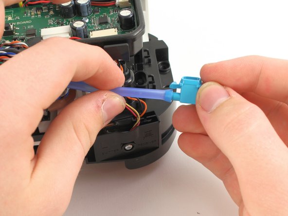

  10. iRobot Braava Jet 240 Nozzle Replacement: crwdns2935265:010crwdnd2935265:01crwdnd2935265:03crwdne2935265:0 iRobot Braava Jet 240 Nozzle Replacement: crwdns2935265:010crwdnd2935265:02crwdnd2935265:03crwdne2935265:0 iRobot Braava Jet 240 Nozzle Replacement: crwdns2935265:010crwdnd2935265:03crwdnd2935265:03crwdne2935265:0
    • Using a Phillips #1 screwdriver, remove the 16 mm screw that holds the nozzle in place.
  11. iRobot Braava Jet 240 Nozzle Replacement: crwdns2935265:011crwdnd2935265:01crwdnd2935265:01crwdne2935265:0
    • Continue unscrewing the 16 mm screw until it comes out of the nozzle.

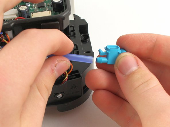

  12. iRobot Braava Jet 240 Nozzle Replacement: crwdns2935265:012crwdnd2935265:01crwdnd2935265:03crwdne2935265:0 iRobot Braava Jet 240 Nozzle Replacement: crwdns2935265:012crwdnd2935265:02crwdnd2935265:03crwdne2935265:0 iRobot Braava Jet 240 Nozzle Replacement: crwdns2935265:012crwdnd2935265:03crwdnd2935265:03crwdne2935265:0
    • Gently remove the tube from the nozzle.
