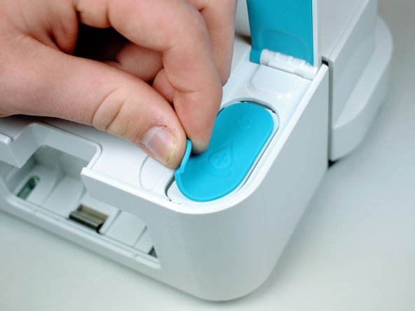

      • Turn the device off.
    2. iRobot Braava Jet 240 Filter Replacement: crwdns2935265:02crwdnd2935265:01crwdnd2935265:02crwdne2935265:0 iRobot Braava Jet 240 Filter Replacement: crwdns2935265:02crwdnd2935265:02crwdnd2935265:02crwdne2935265:0
      • Use your fingers to gently pop out the battery.

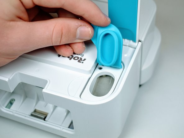

      • Lift the handle to access the filter.
    2. iRobot Braava Jet 240 Filter Replacement: crwdns2935265:04crwdnd2935265:01crwdnd2935265:03crwdne2935265:0 iRobot Braava Jet 240 Filter Replacement: crwdns2935265:04crwdnd2935265:02crwdnd2935265:03crwdne2935265:0 iRobot Braava Jet 240 Filter Replacement: crwdns2935265:04crwdnd2935265:03crwdnd2935265:03crwdne2935265:0

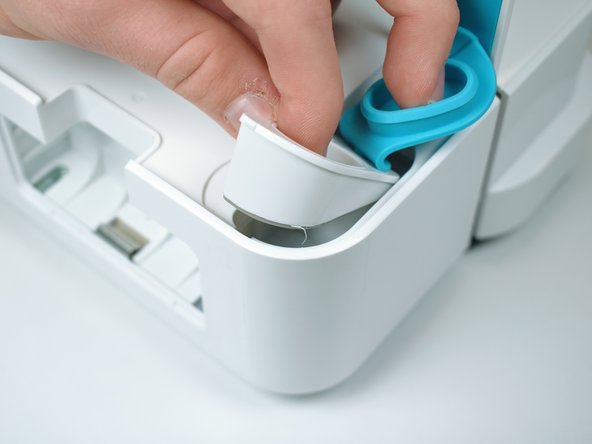

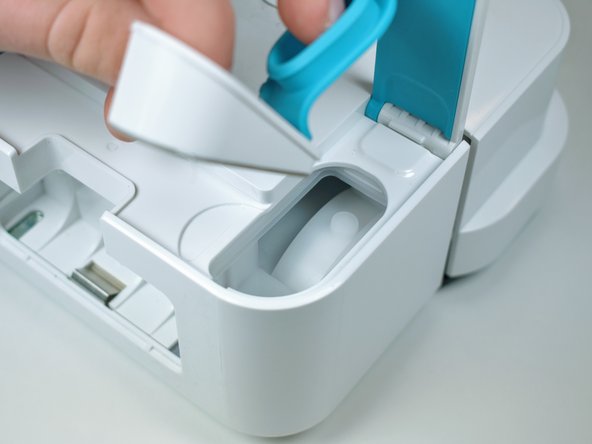

      • Pull up the filter cover.
    3. iRobot Braava Jet 240 Filter Replacement: crwdns2935265:05crwdnd2935265:01crwdnd2935265:03crwdne2935265:0 iRobot Braava Jet 240 Filter Replacement: crwdns2935265:05crwdnd2935265:02crwdnd2935265:03crwdne2935265:0 iRobot Braava Jet 240 Filter Replacement: crwdns2935265:05crwdnd2935265:03crwdnd2935265:03crwdne2935265:0
      • Insert your finger into the filter and pull it up to remove it from the device.
