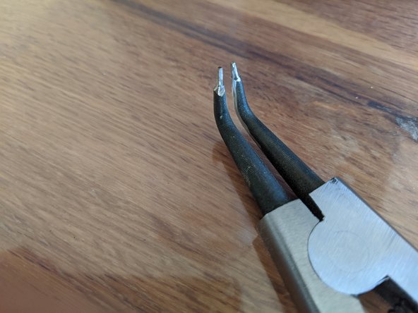

  8. iRobot Braava 380t Teardown: crwdns2935265:08crwdnd2935265:01crwdnd2935265:02crwdne2935265:0 iRobot Braava 380t Teardown: crwdns2935265:08crwdnd2935265:02crwdnd2935265:02crwdne2935265:0
    • Remove the circlip using special pliers (cut here to be small enough)
    • Take out the wheels, and remove all the stuck hair and dirt.

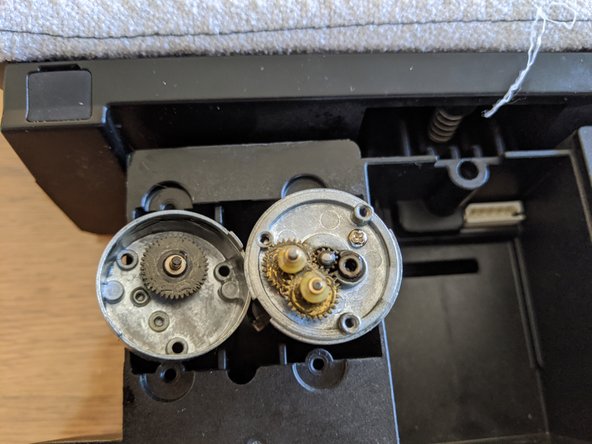

  10. iRobot Braava 380t Teardown: crwdns2935265:010crwdnd2935265:01crwdnd2935265:02crwdne2935265:0 iRobot Braava 380t Teardown: crwdns2935265:010crwdnd2935265:02crwdnd2935265:02crwdne2935265:0
    • You can then take out the motor and possibly dismantle the gearbox. But it's no use, as I didn't find any hair inside.
To reassemble your device, follow the instructions in reverse order.
