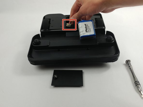

    • Flip device upside down
  2. iRobot Braava 380t Battery Replacement: crwdns2935265:02crwdnd2935265:01crwdnd2935265:01crwdne2935265:0
    • Using a 4mm flat head screw driver, remove the screw holding the battery cover.
  3. iRobot Braava 380t Battery Replacement: crwdns2935265:03crwdnd2935265:01crwdnd2935265:01crwdne2935265:0
    • Remove cover and place it to the side.
  4. iRobot Braava 380t Battery Replacement: crwdns2935265:04crwdnd2935265:01crwdnd2935265:02crwdne2935265:0 iRobot Braava 380t Battery Replacement: crwdns2935265:04crwdnd2935265:02crwdnd2935265:02crwdne2935265:0
    • Lift battery out of the casing
    • Gripping the cord close to the base, gently disconnect it by pulling straight up.
