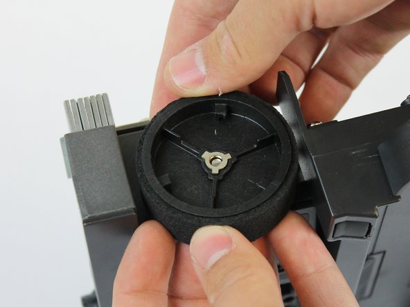

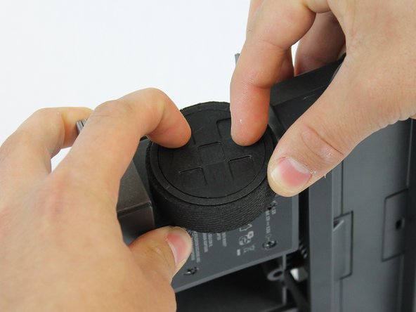

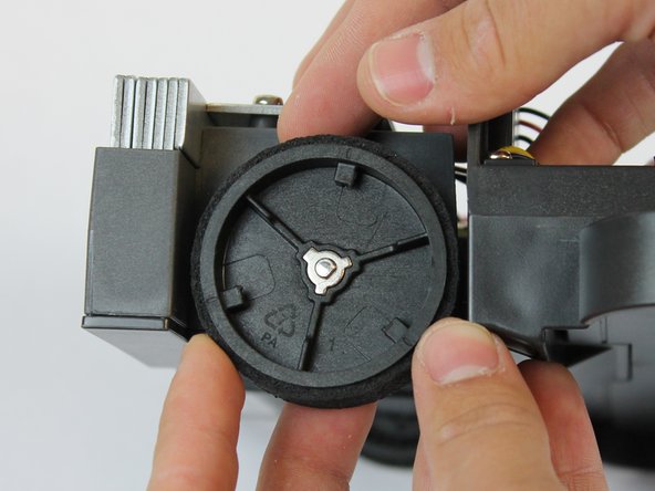

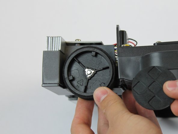

    1. iRobot Braava 320 Wheel Replacement, Wheel: crwdns2935265:06crwdnd2935265:01crwdnd2935265:03crwdne2935265:0 iRobot Braava 320 Wheel Replacement, Wheel: crwdns2935265:06crwdnd2935265:02crwdnd2935265:03crwdne2935265:0 iRobot Braava 320 Wheel Replacement, Wheel: crwdns2935265:06crwdnd2935265:03crwdnd2935265:03crwdne2935265:0
      • To remove the wheel covers, hold the wheel in place with one hand while turning the cover clock-wise with the other.
      • The cover should come off as soon as you hear a 'click' sound.
      • When replacing the cover, align the notches on the cover just to the right of the ones on the wheel.

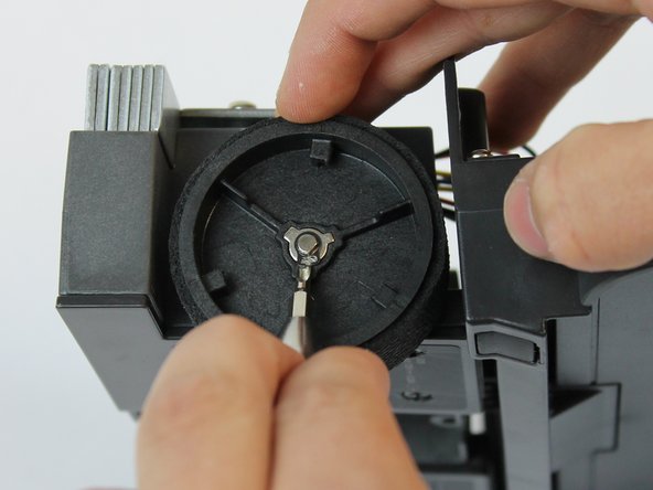

    2. iRobot Braava 320 Wheel Replacement: crwdns2935265:07crwdnd2935265:01crwdnd2935265:03crwdne2935265:0 iRobot Braava 320 Wheel Replacement: crwdns2935265:07crwdnd2935265:02crwdnd2935265:03crwdne2935265:0 iRobot Braava 320 Wheel Replacement: crwdns2935265:07crwdnd2935265:03crwdnd2935265:03crwdne2935265:0
      • Using a small Flathead screwdriver, remove the small black clip in the center of the wheel.
      • To ensure the clip does not fly off, place your hand over the wheel to cover it as you remove the clip.

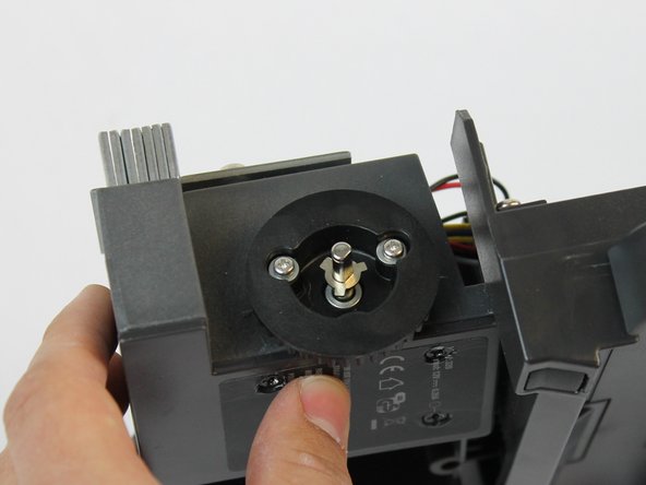

    3. iRobot Braava 320 Wheel Replacement: crwdns2935265:08crwdnd2935265:01crwdnd2935265:03crwdne2935265:0 iRobot Braava 320 Wheel Replacement: crwdns2935265:08crwdnd2935265:02crwdnd2935265:03crwdne2935265:0 iRobot Braava 320 Wheel Replacement: crwdns2935265:08crwdnd2935265:03crwdnd2935265:03crwdne2935265:0
      • Once the small black clip is removed, the wheel should come off by gently pulling on it.
      • Be careful not to lose the two small chrome pieces located on each side of the wheel.
