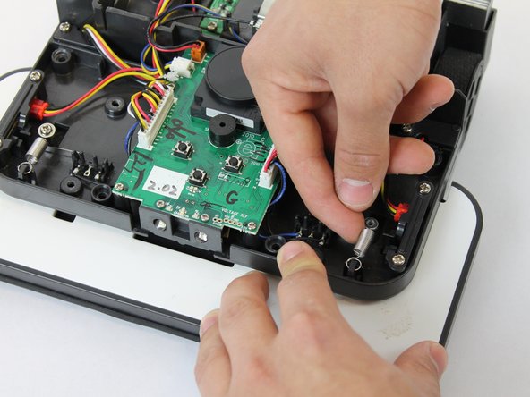

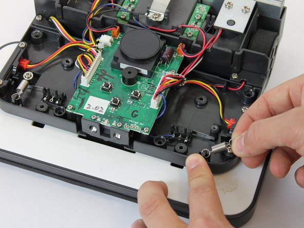

  7. iRobot Braava 320 Deck Plate Assembly  Replacement: crwdns2935265:07crwdnd2935265:01crwdnd2935265:03crwdne2935265:0 iRobot Braava 320 Deck Plate Assembly  Replacement: crwdns2935265:07crwdnd2935265:02crwdnd2935265:03crwdne2935265:0 iRobot Braava 320 Deck Plate Assembly  Replacement: crwdns2935265:07crwdnd2935265:03crwdnd2935265:03crwdne2935265:0
    • Remove the two 12mm Phillips #0 screws that hold the two springs onto the deck plate assembly.
    • Remove the two springs by gently lifting them up.
