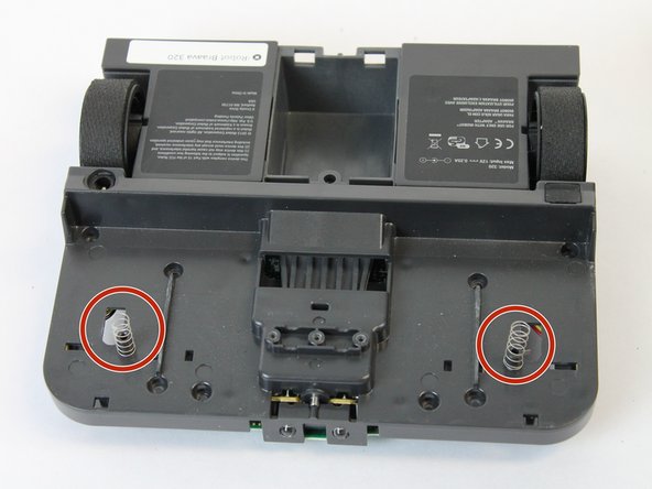

  6. iRobot Braava 320 Deck Plate Arms Replacement, Deck Plate Assembly: crwdns2935265:06crwdnd2935265:01crwdnd2935265:01crwdne2935265:0
    • With the shell off, flip the iRobot over and remove the four 10mm Phillips #0 screws holding the deck plate assembly on.
  7. iRobot Braava 320 Deck Plate Arms Replacement: crwdns2935265:07crwdnd2935265:01crwdnd2935265:03crwdne2935265:0 iRobot Braava 320 Deck Plate Arms Replacement: crwdns2935265:07crwdnd2935265:02crwdnd2935265:03crwdne2935265:0 iRobot Braava 320 Deck Plate Arms Replacement: crwdns2935265:07crwdnd2935265:03crwdnd2935265:03crwdne2935265:0
    • Remove the two 12mm Phillips #0 screws that hold the two springs onto the deck plate assembly.
    • Remove the two springs by gently lifting them up.

  10. iRobot Braava 320 Deck Plate Arms Replacement, Deck Plate Arms: crwdns2935265:010crwdnd2935265:01crwdnd2935265:01crwdne2935265:0
    • With the deck plate off, remove the three 10mm Phillips #2 screw
  11. iRobot Braava 320 Deck Plate Arms Replacement: crwdns2935265:011crwdnd2935265:01crwdnd2935265:02crwdne2935265:0 iRobot Braava 320 Deck Plate Arms Replacement: crwdns2935265:011crwdnd2935265:02crwdnd2935265:02crwdne2935265:0
    • Be careful when removing the arms, do not lose the springs located under the arms.
