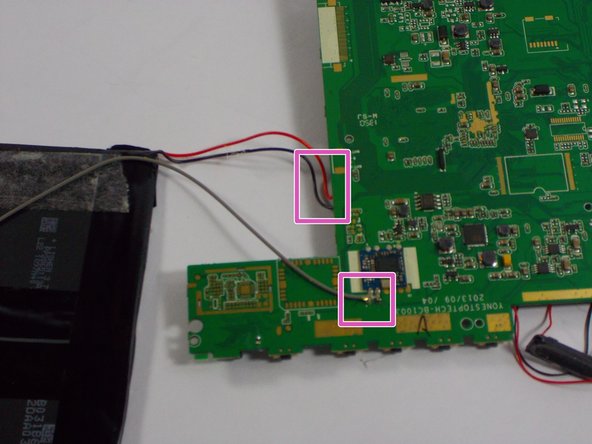

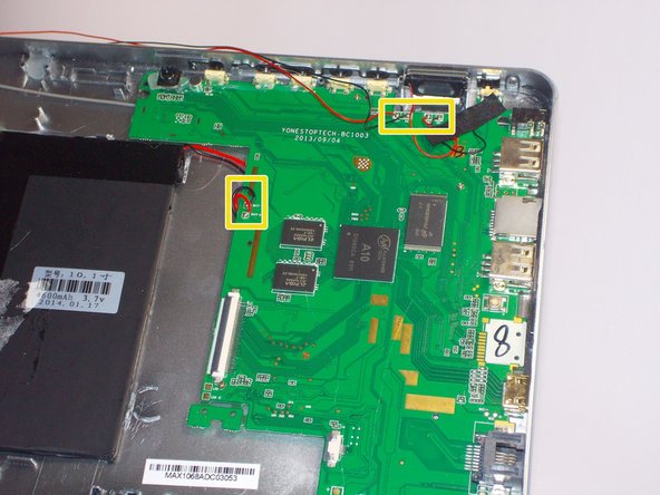

  4. iRULU AX106 Logic Board Replacement, Logic Board: crwdns2935265:04crwdnd2935265:01crwdnd2935265:02crwdne2935265:0 iRULU AX106 Logic Board Replacement, Logic Board: crwdns2935265:04crwdnd2935265:02crwdnd2935265:02crwdne2935265:0
    Desoldering Pump
    $3.99
    • Locate where the speaker wires are attached to the logic board, and use a soldering iron and solder sucker to remove the wires from the board.
    • Then, locate the wires connecting the logic board to the battery and desolder them the same way.
    • The soldering iron is extremely hot. Please use caution when using these tools.
  5. iRULU AX106 Logic Board Replacement: crwdns2935265:05crwdnd2935265:01crwdnd2935265:02crwdne2935265:0 iRULU AX106 Logic Board Replacement: crwdns2935265:05crwdnd2935265:02crwdnd2935265:02crwdne2935265:0
    • Completely remove the old logic board, being careful not to damage any wires
    • Place the new logic board exactly where the old one was located. Leave the wires in an easily accessible position.
    • Solder the wires in the corresponding places exactly where you disconnected them from the old logic board.
