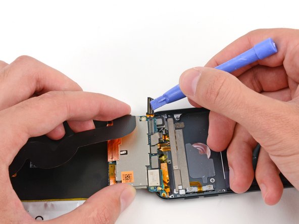

      • Flip the entire assembly over, showing the back of the logic board.
      • Use a plastic opening tool to disconnect the digitizer cable from the logic board.
    25. iPod Touch 6th Generation Display Assembly Replacement: crwdns2935265:025crwdnd2935265:01crwdnd2935265:02crwdne2935265:0 iPod Touch 6th Generation Display Assembly Replacement: crwdns2935265:025crwdnd2935265:02crwdnd2935265:02crwdne2935265:0
      • Use a plastic opening tool to disconnect the display cable from its socket.
    26. iPod Touch 6th Generation Display Assembly Replacement: crwdns2935265:026crwdnd2935265:01crwdnd2935265:03crwdne2935265:0 iPod Touch 6th Generation Display Assembly Replacement: crwdns2935265:026crwdnd2935265:02crwdnd2935265:03crwdne2935265:0 iPod Touch 6th Generation Display Assembly Replacement: crwdns2935265:026crwdnd2935265:03crwdnd2935265:03crwdne2935265:0
      • Flip the Lightning connector/logic board assembly back over to expose the top of the logic board.
      • The display cable is lightly adhered to the top of the logic board.
      • Use the flat end of a spudger to peel the display cable up from the logic board.
    27. iPod Touch 6th Generation Display Assembly Replacement: crwdns2935265:027crwdnd2935265:01crwdnd2935265:02crwdne2935265:0 iPod Touch 6th Generation Display Assembly Replacement: crwdns2935265:027crwdnd2935265:02crwdnd2935265:02crwdne2935265:0
      • Finally remove the display assembly from the iPod
