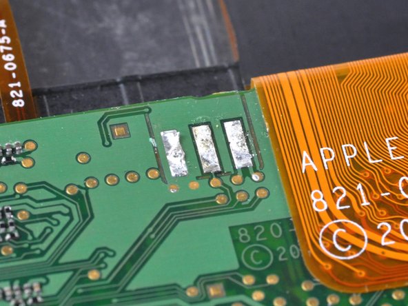

    5. iPod Touch 3rd Generation Battery Replacement: crwdns2935265:022crwdnd2935265:01crwdnd2935265:02crwdne2935265:0 iPod Touch 3rd Generation Battery Replacement: crwdns2935265:022crwdnd2935265:02crwdnd2935265:02crwdne2935265:0
      FixHub Smart Soldering Iron
      $79.95
      • Next, use the tip of a soldering iron to flatten out the solder on the logic board solder pads. The pictures show a 'before' and 'after' shot.
      • Remember not to heat up the pads too much.

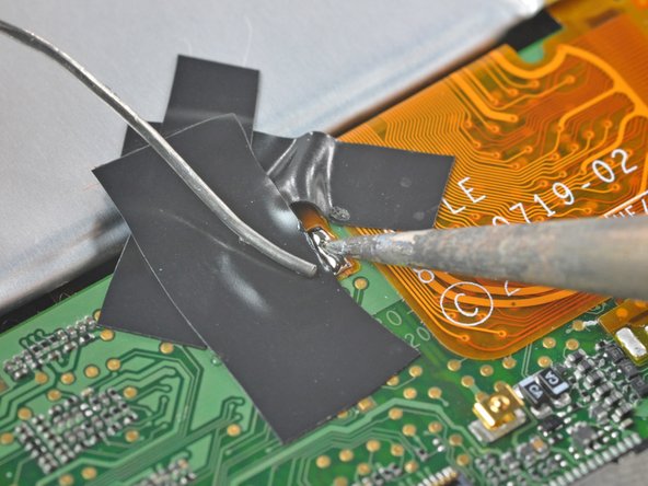

      • Place your battery in the rear panel, with the cable side down, and use two small strips of electrical tape to hold the cable against the solder pads.
      • Installing the battery upside down (with the cable facing up) will destroy the logic board.
      • Place a strip of tape over the end of the battery ribbon cable to both cover two of the solder pads and hold the contacts down against the logic board.
      • Heat the rightmost contact until the solder below melts and apply a small amount of solder to the contact, allowing it to flow through the two holes in the cable and down to the logic board.
      • Do not apply too much solder. The amount required for a proper bond is miniscule.
      • As soon as the solder has flowed into the joint, remove both the solder and the iron.
    7. iPod Touch 3rd Generation Battery Replacement: crwdns2935265:024crwdnd2935265:01crwdnd2935265:02crwdne2935265:0 iPod Touch 3rd Generation Battery Replacement: crwdns2935265:024crwdnd2935265:02crwdnd2935265:02crwdne2935265:0
      • Remove the piece of tape covering the remaining two leads. If you are satisfied with the position of the cable relative to the pads on the board, proceed. If not, de-solder the first connection and try again.
      • Solder the two remaining pads to the logic board, being mindful of overheating the cable or board.
    8. iPod Touch 3rd Generation Battery Replacement: crwdns2935265:025crwdnd2935265:01crwdnd2935265:01crwdne2935265:0
      • Don't forget to reapply the piece of tape over the solder pads to prevent any shorts.
