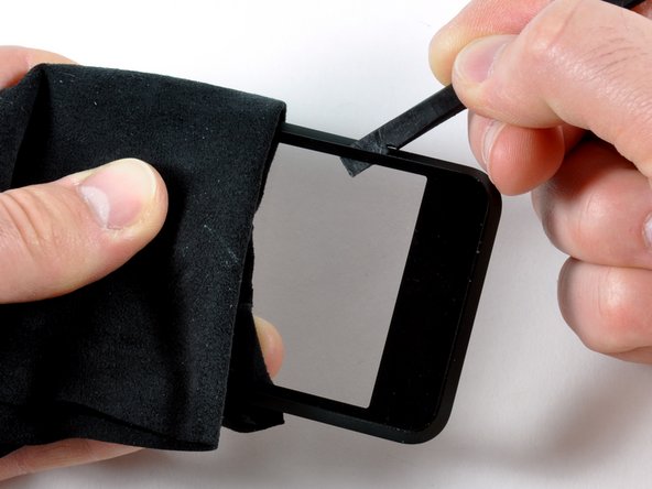

    1. iPod Touch 1st Generation Front Panel Replacement, Front Panel: crwdns2935265:014crwdnd2935265:01crwdnd2935265:01crwdne2935265:0
      • The front panel is held in place by a heat-sensitive glue that bonds the panel to the frame on all four sides.
      • Use a hair dryer or heat gun to loosen the glue around the perimeter of the front panel.
    2. iPod Touch 1st Generation Front Panel Replacement: crwdns2935265:015crwdnd2935265:01crwdnd2935265:02crwdne2935265:0 iPod Touch 1st Generation Front Panel Replacement: crwdns2935265:015crwdnd2935265:02crwdnd2935265:02crwdne2935265:0
      • The front panel will be hot! Use a cloth or rag to avoid burning yourself while holding it.
      • Wedge the spudger in between the frame and front display in the upper left corner of the iPod, as shown in the first picture.
      • This action should separate the frame from the front display a bit (as illustrated in the second picture), and allow you to insert the spudger in between display and frame (next step).
    3. iPod Touch 1st Generation Front Panel Replacement: crwdns2935265:016crwdnd2935265:01crwdnd2935265:02crwdne2935265:0 iPod Touch 1st Generation Front Panel Replacement: crwdns2935265:016crwdnd2935265:02crwdnd2935265:02crwdne2935265:0
      • Gently insert the spudger in between the frame and front display.
      • Carefully work around the edge of the front panel to separate the upper portion of the front panel from the black metal framework.
    4. iPod Touch 1st Generation Front Panel Replacement: crwdns2935265:017crwdnd2935265:01crwdnd2935265:03crwdne2935265:0 iPod Touch 1st Generation Front Panel Replacement: crwdns2935265:017crwdnd2935265:02crwdnd2935265:03crwdne2935265:0 iPod Touch 1st Generation Front Panel Replacement: crwdns2935265:017crwdnd2935265:03crwdnd2935265:03crwdne2935265:0
