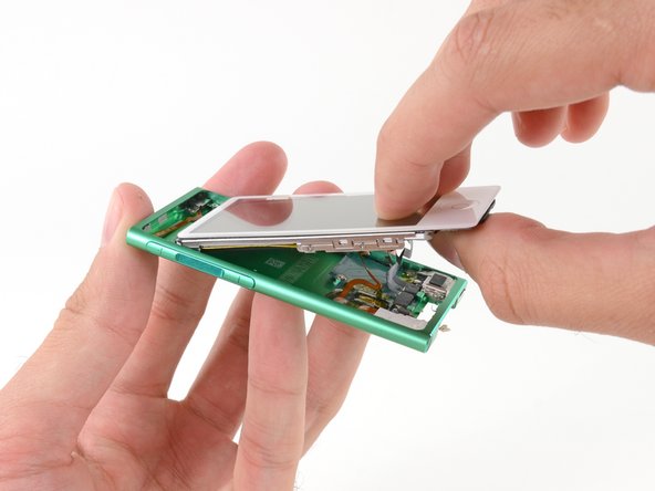

  6. iPod Nano 7th Generation Teardown: crwdns2935265:06crwdnd2935265:01crwdnd2935265:03crwdne2935265:0 iPod Nano 7th Generation Teardown: crwdns2935265:06crwdnd2935265:02crwdnd2935265:03crwdne2935265:0 iPod Nano 7th Generation Teardown: crwdns2935265:06crwdnd2935265:03crwdnd2935265:03crwdne2935265:0
    • With the screws removed, we grab a plastic opening tool—our favorite way to crack open a new iPod.
    • After a bit of wiggling, we manage to pry the display assembly up from the rear case, only to be met with several cables blocking its complete removal.

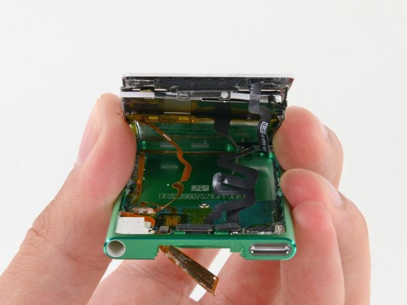

  7. iPod Nano 7th Generation Teardown: crwdns2935265:07crwdnd2935265:01crwdnd2935265:02crwdne2935265:0 iPod Nano 7th Generation Teardown: crwdns2935265:07crwdnd2935265:02crwdnd2935265:02crwdne2935265:0
    • Two quick flicks disconnect the LCD and digitizer cables, leaving only the battery cable as a final umbilical cord between the two halves of the device.
    • The battery is both adhered to the back of the display assembly and soldered to the logic board.
    • Unfortunately, the connivance and cost savings of adhesive come at the cost of repairability.

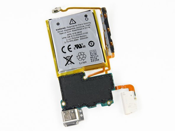

  9. iPod Nano 7th Generation Teardown: crwdns2935265:09crwdnd2935265:01crwdnd2935265:03crwdne2935265:0 iPod Nano 7th Generation Teardown: crwdns2935265:09crwdnd2935265:02crwdnd2935265:03crwdne2935265:0 iPod Nano 7th Generation Teardown: crwdns2935265:09crwdnd2935265:03crwdnd2935265:03crwdne2935265:0
    • There's an adorable plastic pull tab underneath the battery. It's likely there for battery removal, but we aren't sure it's up to the task.
    • It seems the adhesive holding down the battery is much too strong for the feeble pull tab to break through.
    • Forgoing the tab in favor of some spudgering, we're able to pry the 3.7 V, 0.8 Wh, 220 mAh battery off the back of the display assembly.
    • 0.8 Wh is more than twice that of the iPod Nano 6th Generation's 0.39 Wh rating.

  13. iPod Nano 7th Generation Teardown: crwdns2935265:013crwdnd2935265:01crwdnd2935265:02crwdne2935265:0 iPod Nano 7th Generation Teardown: crwdns2935265:013crwdnd2935265:02crwdnd2935265:02crwdne2935265:0
    • Pulling out the logic board really feels like pulling out the entire iPod—the battery, button cable, Lightning connector, and headphone jack all come with it.
    • On the flip-side we found an intriguing fibrous tape covering the EMI shields on the ICs. It's probably there to insulate against contact with the rear case.

Tried to replace a broken digitizer and ended up breaking the LCD. These instructions don't make clear in Step #6 how deep you need to get the opening tool in order to pull out the ENTIRE DISPLAY ASSEMBLY. The picture indicates, quite wrongly, that you only need to get the tip of the opening tool under the glass. This will result in separating the digitizer from the screen prematurely, and then breaking the LCD screen. The reality is that you must get the tool deep under the metal base of the assembly and pry the whole thing out with much force (it's glued on both sides). Frustrating.
Carl - crwdns2934203:0crwdne2934203:0
True, I broke the LCD screen with this method. Glue is everywhere in this device.
