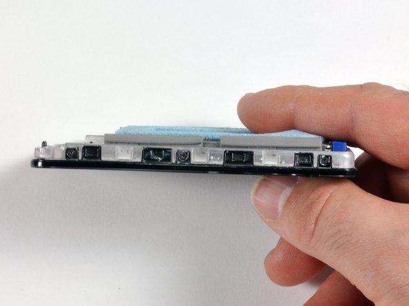

    • Use this photo of the OPENED iPod for the reference, in order to locate the areas where the retaining clips are - 4 per side, one on top and two at the bottom. It should save you a lot of frustration and help avoid scratching the plastic cover.

    • There are four retaining clips on each side of the iPod. An iPod opening tool will be used to separate the plastic front from the metal back of the iPod.
    • Insert the iPod opening tool into the left side of the iPod, with the edge of the tool pointing towards the metal back.
    • A small guitar pick can be extremely helpful in opening the iPod. Simply insert it and slide the pick around the case to free the clips to streamline the process.
    • Gently enlarge the existing crevice by wiggling the iPod opening tool and moving it to the left.
    • Continue doing so until the entire side of the iPod is loose.
    • You can then insert an iPod opening tool to the right of the Hold button. Be very careful while inserting the tool, as the display is very fragile.

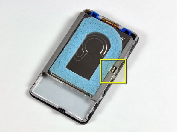

    • Lift up the hard drive to expose the headphone jack ribbon connector (indicated by the yellow box).
    • If the hard drive bumpers come loose, make sure to put them back with the notch as shown in the picture.
