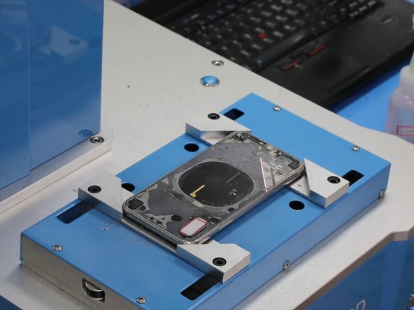

    • Firstly, we put the cellphone without disassemble on the focusing area and run the black wheel. It can test focal length automatically. Meanwhile the blue light will sparkle once focusing the best distance.
    • After that, we put the phone on the location mold which has a unique patented technology. It can calibrate the center automatically and it is fast and accurate. The error is less than 0.002mm.
  2. iPhone X XS XSMAX Broken Back Glass Replacement, Start Laser Separating: crwdns2935265:02crwdnd2935265:01crwdnd2935265:03crwdne2935265:0 iPhone X XS XSMAX Broken Back Glass Replacement, Start Laser Separating: crwdns2935265:02crwdnd2935265:02crwdnd2935265:03crwdne2935265:0 iPhone X XS XSMAX Broken Back Glass Replacement, Start Laser Separating: crwdns2935265:02crwdnd2935265:03crwdnd2935265:03crwdne2935265:0
    • The next part is using the computer and find the drawing of iPhone X/XS/XS MAX once we fix the position.
    • Then we click “Mark” to start the laser separation. Here the machine will laser two times to separate the back glass.
    • Note: Be sure to confirm that the drawings are correct.

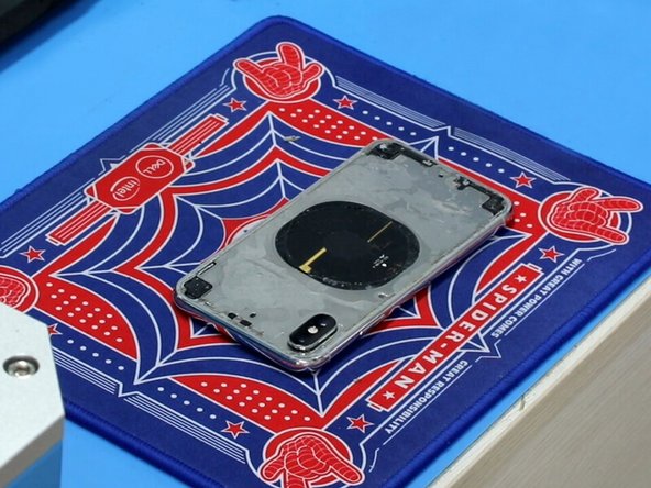

  3. iPhone X XS XSMAX Broken Back Glass Replacement, Remove Glass And Clean Glue: crwdns2935265:03crwdnd2935265:01crwdnd2935265:03crwdne2935265:0 iPhone X XS XSMAX Broken Back Glass Replacement, Remove Glass And Clean Glue: crwdns2935265:03crwdnd2935265:02crwdnd2935265:03crwdne2935265:0 iPhone X XS XSMAX Broken Back Glass Replacement, Remove Glass And Clean Glue: crwdns2935265:03crwdnd2935265:03crwdnd2935265:03crwdne2935265:0
    • After the laser work is done, we can remove the iPhone XS back glass with a blade, a pry piece and pliers successfully in a short time.
    • When the glass teardown, we have to use the laser machine again to remove the residual glue.
    • If you don't use a laser machine, it is quite challenging to remove the residual glue, but the hair dryer or heat gun makes the process easier.
  4. iPhone X XS XSMAX Broken Back Glass Replacement, Install New Glass: crwdns2935265:04crwdnd2935265:01crwdnd2935265:03crwdne2935265:0 iPhone X XS XSMAX Broken Back Glass Replacement, Install New Glass: crwdns2935265:04crwdnd2935265:02crwdnd2935265:03crwdne2935265:0 iPhone X XS XSMAX Broken Back Glass Replacement, Install New Glass: crwdns2935265:04crwdnd2935265:03crwdnd2935265:03crwdne2935265:0
    • We can add glue on the back frame with a glue gun.
    • It is better to add glue without rules.
    • Finally, stick the new glass.
