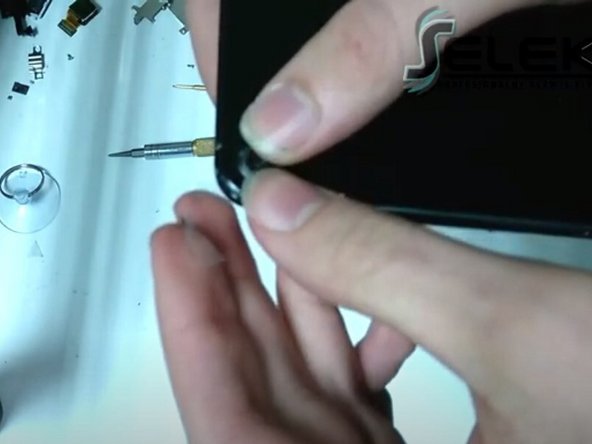

      • Use a pair of tweezers to carefully remove the remains of any broken glass from the cracked camera cover.
      • While removing the broken glass, be very careful that the glass and your tweezers do not scratch the camera's lens. If the lens is scratched, it may prevent the camera from focusing properly.
    2. iPhone 7 Camera Cover Glass Replacement: crwdns2935265:02crwdnd2935265:01crwdnd2935265:02crwdne2935265:0 iPhone 7 Camera Cover Glass Replacement: crwdns2935265:02crwdnd2935265:02crwdnd2935265:02crwdne2935265:0
      • Use a soft cloth to clean the camera's lens of small glass shards.
    3. iPhone 7 Camera Cover Glass Replacement: crwdns2935265:03crwdnd2935265:01crwdnd2935265:03crwdne2935265:0 iPhone 7 Camera Cover Glass Replacement: crwdns2935265:03crwdnd2935265:02crwdnd2935265:03crwdne2935265:0 iPhone 7 Camera Cover Glass Replacement: crwdns2935265:03crwdnd2935265:03crwdnd2935265:03crwdne2935265:0
      • Unlock the phone and open the Camera app.
      • Test the camera by making sure that it focuses properly and there is no visible residue left on the lens.
      • If the rear-facing camera continues to have trouble focusing, continue carefully removing glass shards from the camera cover.
      • If you have removed all glass shards and the camera still does not focus properly, the lens may be scratched. Use the iPhone 7 Rear Camera replacement guide to replace the phone's rear-facing camera.
    4. iPhone 7 Camera Cover Glass Replacement: crwdns2935265:04crwdnd2935265:01crwdnd2935265:02crwdne2935265:0 iPhone 7 Camera Cover Glass Replacement: crwdns2935265:04crwdnd2935265:02crwdnd2935265:02crwdne2935265:0
      • Use a paperclip to remove the adhesive from around the camera's lens.
      • Use a soft cloth to remove any residue from the adhesive.
    5. iPhone 7 Camera Cover Glass Replacement: crwdns2935265:05crwdnd2935265:01crwdnd2935265:03crwdne2935265:0 iPhone 7 Camera Cover Glass Replacement: crwdns2935265:05crwdnd2935265:02crwdnd2935265:03crwdne2935265:0 iPhone 7 Camera Cover Glass Replacement: crwdns2935265:05crwdnd2935265:03crwdnd2935265:03crwdne2935265:0
      • Install a new camera cover and attach it using silicone-based adhesive.
      • Make sure not to apply too much adhesive to the camera cover. If too much adhesive is applied, it may obstruct the camera's lens.
      • Press gently on the newly installed camera cover to securely attach the cover.
After replacing the broken camera cover with a new one, open the phone’s Camera app. Check and make sure that the rear-facing camera is able to focus properly.

does the glass come with glue already on it?
kolineal - crwdns2934203:0crwdne2934203:0 crwdns2950251:0crwdne2950251:0
No, it does not come with the glue, you have to buy Silicone based adhesive so the phone can remain waterproof.
megaspeed - crwdns2934203:0crwdne2934203:0 crwdns2950251:0crwdne2950251:0
The Video is showing how to replace the Glass.
Why do we need to buy this suggested part ‘ iPhone 7 Rear Camera Lens Cover’ (the whole Cover not just the Glass)?
Installing the whole cover needs a complete different Guide, including opening the iphone...
Simon Bonorand - crwdns2934203:0crwdne2934203:0 crwdns2950251:0crwdne2950251:0
+1 agreed
this guide(link) is not at all helpful
Chris Farker - crwdns2934203:0crwdne2934203:0 crwdns2950251:0crwdne2950251:0
Where is the link to buy replacement camera lens?
