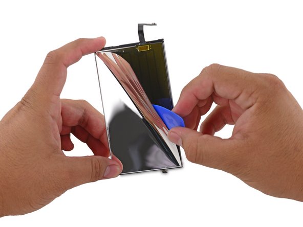

  4. iPhone 6s Display Teardown: crwdns2935265:04crwdnd2935265:01crwdnd2935265:03crwdne2935265:0 iPhone 6s Display Teardown: crwdns2935265:04crwdnd2935265:02crwdnd2935265:03crwdne2935265:0 iPhone 6s Display Teardown: crwdns2935265:04crwdnd2935265:03crwdnd2935265:03crwdne2935265:0

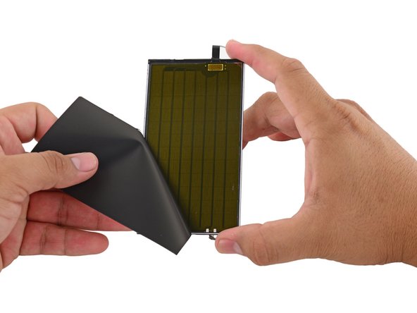

    • With the easy stuff out of the way, our operation continues by separating the backlight and this metal-backed layer.
    • This mylar sheet immediately grabbed our attention. On older iPhones, this sheet was one of the layers that made up the backlight—it now covers a new mystery component.
    • The display is actually so thin you can see through it—the mylar keeps whatever is hidden under it, well, hidden during normal use.

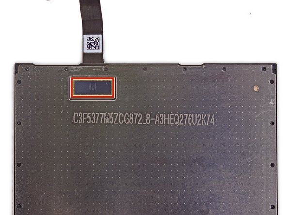

  6. iPhone 6s Display Teardown: crwdns2935265:06crwdnd2935265:01crwdnd2935265:02crwdne2935265:0 iPhone 6s Display Teardown: crwdns2935265:06crwdnd2935265:02crwdnd2935265:02crwdne2935265:0
    • Back to those capacitative sensors we mentioned. Under that funky film is certainly a grid of...something.
    • Each of the gold rectangles on this back panel is a single plate of a parallel plate capacitor.
    • Each box has a tiny trace (the dark areas are actually highways of many traces) running back to the control chip. Which...
    • ...We find on the backside of the panel, probably. This Apple-custom chip is responsible for wrangling the capacitors—keeping them charged and measuring changes in current to and from each.

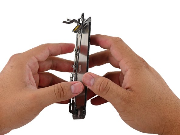

  7. iPhone 6s Display Teardown: crwdns2935265:07crwdnd2935265:01crwdnd2935265:01crwdne2935265:0
    • Apple worked closely with Corning, the makers of Gorilla Glass, to develop a pliable glass for the new iPhone's glass cover.
    • Pressing down onto the glass bends the glass very slightly at the point of contact, shortening the distance between your finger and the corresponding capacitor plate in the array beneath the display. This registers a "push" rather than a "touch".
    • In a parallel plate capacitor, capacitance is inversely proportional to distance—a shorter distance means greater capacity for charge on the plate, so the IC would measure an inflow of current to the sensor board.
    • While the plates are similar to those in a touch screen, they are too large to pinpoint a finger press. Luckily they don't have to.
    • The "real" digitizer is still present for precision tracking, these plates only have to detect a flex in the glass—not where it occurs.

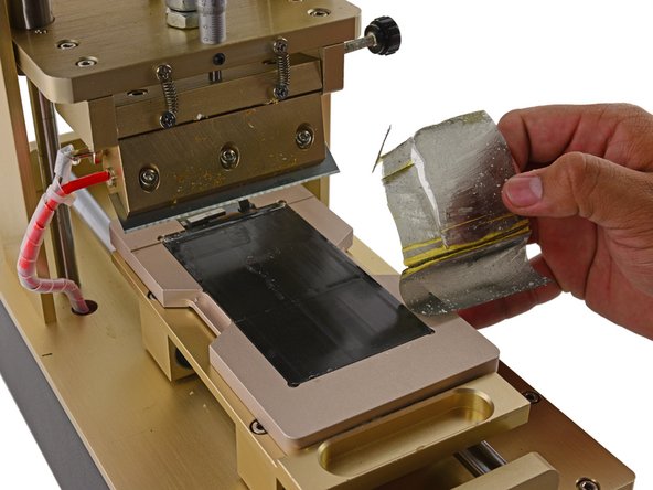

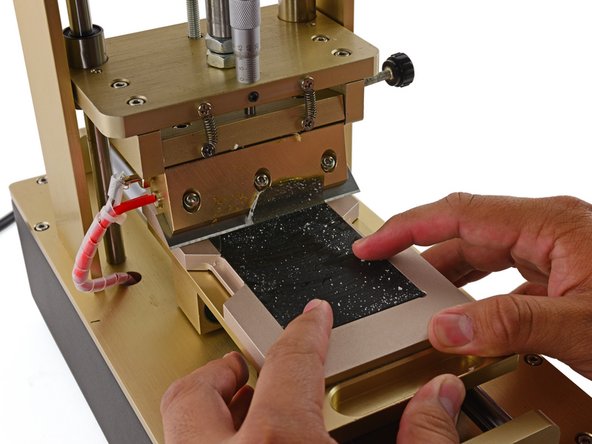

  9. iPhone 6s Display Teardown: crwdns2935265:09crwdnd2935265:01crwdnd2935265:03crwdne2935265:0 iPhone 6s Display Teardown: crwdns2935265:09crwdnd2935265:02crwdnd2935265:03crwdne2935265:0 iPhone 6s Display Teardown: crwdns2935265:09crwdnd2935265:03crwdnd2935265:03crwdne2935265:0
    • With the glass removed we are left with a rather messy-looking LCD—removing the glass has really done a number on the polarizing film.
    • Lucky for us, the folks from STS Parts brought their guillotine (also known as a Polarizer Remover Machine) that scrapes it up like gum off a shoe.
    • The film is destroyed in the removal, but replacements are easy to come by.

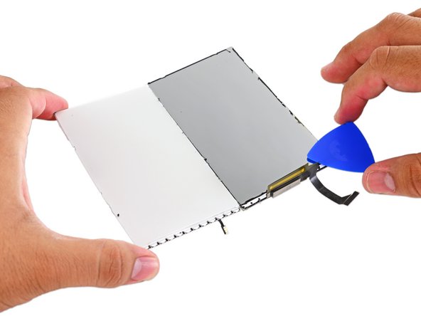

    • Last to come off of the display is the edge-lit LED backlight—a common type of backlight found in smartphones.
    • An edge-lit backlight, like the name suggests, only has LEDs on one edge of the backlight. Light from these diodes is spread evenly over the screen by the diffuser—a multi-layer, semi-transparent plastic sheeting.
    • As mentioned earlier, the reflective mylar layer was previously one of the layers of the backlight.
    • In this iteration of the iPhone the mylar layer now serves two purposes; the new use, to obscure the 3D Touch sensors from view, and the traditional use, to reflect diffused light outward instead of wasting light on the internals of the iPhone.
