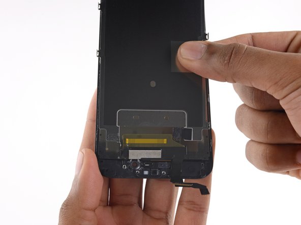

  3. iPhone 6s Display EMI Shield Replacement: crwdns2935265:03crwdnd2935265:01crwdnd2935265:01crwdne2935265:0
    • Opening the display on the 6s separates a thin strip of adhesive around the perimeter of the display. If you prefer to replace the adhesive, have a set of new adhesive strips ready before you continue. It's possible to complete the repair without replacing the adhesive, and you probably won't notice any difference in functionality.
    • Apply a suction cup to the lower left corner of the display assembly.
    • Take care not to place the suction cup over the home button.
    • If your display is badly cracked, covering it with a layer of clear packing tape may allow the suction cup to adhere. Alternatively, very strong tape may be used instead of the suction cup. If all else fails, you can superglue the suction cup to the broken screen.

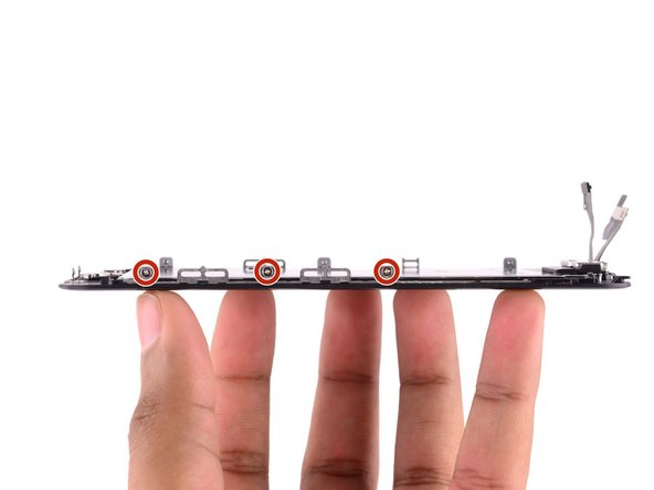

    on the third picture, the screen is opened more than 90 degrees.
    Mirza Zohaib - crwdns2934203:0crwdne2934203:0
    It said about 90 degrees
    Nick Stine -
    Actually it literally says, “Don't open the display more than 90º, as it is still connected at the top by three cables that may break if stretched.”
    David -

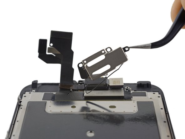

    In the second picture I was originally wondering what that diagonal piece of material was. Now that I've done a repair I can say that it's the sticky adhesive around the edge of the phone lifting up with the screen.
    jonl - crwdns2934203:0crwdne2934203:0

  17. iPhone 6s Display EMI Shield Replacement, Unfasten the display cable bracket: crwdns2935265:017crwdnd2935265:01crwdnd2935265:01crwdne2935265:0
    • Remove the following four Phillips screws securing the display cable bracket:
    • Three 1.2 mm screws
    • One 2.8 mm screw
    Thank you for this great guide!
    I was able to skip removing the display assembly and logic board steps and lay the speaker upside down on the bottom edge of the logic board without putting undue pressure on the antenna cable making this a much easier and quicker repair for me. If you choose to leave the display assembly connected, I recommend using a rubber band to hold it to a box of similar size at a 90 degree angle to prevent damage and stress to the attached cables.
    So, the steps I skipped were Steps 16 through 34 and Steps 37 through 45.

    The 1.2mm screw in the top left corner is refusing to come out, any help?
    Harry Allinson - crwdns2934203:0crwdne2934203:0
    I’m also having this issue now, what did you do to get the screw out?
    Belmin Husanovic -
    Sounds common but no solution? I keep working at it but no luck. Anyone find a way in the last few years?
    Kurt Mickelson -
    There’s no trick… Make sure you’ve got the right driver, press down HARD, and crank it. If it’s stripping, check your driver and consider moving up one size. Resources: Screwdriver Best Practices & How to Remove a Stripped Screw - Good luck!
    Jeff Suovanen -

    why does the battery fix kit not include the #00 bit needed to unscrew all 3 1.2mm screws?!?! !#^&@@ off.
    robertdjclark - crwdns2934203:0crwdne2934203:0
    Either a #00 or a #000 bit should work fine here. Some #0 bits will also work if the point is fine enough. Same goes for a lot of JIS bits. As long as it doesn't strip or slip, you're good.
    Jeff Suovanen -

    The "Three 1.2 mm screws" seem to be particularly fragile either that or the PH00 and the PH000 are the incorrect drivers - this part of the guide should be clearer on what driver should be used as every time I touch these screws I seem to strip them 😩
    Hope this helps
    Regards
    Lewis Dexter Litanzios - crwdns2934203:0crwdne2934203:0

  24. iPhone 6s Display EMI Shield Replacement: crwdns2935265:024crwdnd2935265:01crwdnd2935265:03crwdne2935265:0 iPhone 6s Display EMI Shield Replacement: crwdns2935265:024crwdnd2935265:02crwdnd2935265:03crwdne2935265:0 iPhone 6s Display EMI Shield Replacement: crwdns2935265:024crwdnd2935265:03crwdnd2935265:03crwdne2935265:0
    • Lift up and remove the earpiece speaker bracket, peeling up the bracket gasket as you go.
    • Peel up the gasket carefully, as it is thin and can tear easily.
    I temoved the gasket while changing screen. What does the gasket actually do? Is it necessary?
    Atte Veijola - crwdns2934203:0crwdne2934203:0
    Also removed gasket while replacing screen. The phone is now in a startup loop. It won't turn on while unplugged- when plugged to wall outlet, it starts to point of displaying Apple logo then restarts. Could this be a cause?
    foibuls - crwdns2934203:0crwdne2934203:0
    Gasket thing literally does nothing. Couldn't get it back on properly so I peeled the flimsy thing off. No issues with my phone at all.
    Jaspal Goshal - crwdns2934203:0crwdne2934203:0
    Gasket does not seem to have any connection or logic. I just let it be when I could not fit it. Worked fine.
    Niklas Magnusson - crwdns2934203:0crwdne2934203:0
    Isn't the gasket some sort of water resistant seal?
    Nick Stine - crwdns2934203:0crwdne2934203:0
    Gasket always breaks during reinstalling but so far no negative effects.
    Steve - crwdns2934203:0crwdne2934203:0
    I couldn’t fit the gasket back around the metallic piece it surrounds. It run short and I couldn’t reach the bracket screw hole with the gasket screw hole so I left it loose. Everything seems to work fine. But I guess it is there for some reason so I am a bit uneasy….
    Homero - crwdns2934203:0crwdne2934203:0
    I’ve never gotten this rubber piece on without it ripping . I’ve never had a problem with the operation of the phone upon reassembly. I wouldn’t worry about it.
    mcr4u2 - crwdns2934203:0crwdne2934203:0
    A little bit of heat and gentle, patient tugging from both directions with my tweezers got the gasket out whole (although from the sounds of the other comments it is not important).
    Thomas Hayes - crwdns2934203:0crwdne2934203:0

  31. iPhone 6s Display EMI Shield Replacement, Display EMI Shield: crwdns2935265:031crwdnd2935265:01crwdnd2935265:03crwdne2935265:0 iPhone 6s Display EMI Shield Replacement, Display EMI Shield: crwdns2935265:031crwdnd2935265:02crwdnd2935265:03crwdne2935265:0 iPhone 6s Display EMI Shield Replacement, Display EMI Shield: crwdns2935265:031crwdnd2935265:03crwdnd2935265:03crwdne2935265:0
    • Remove the following seven 1.3 mm Phillips screws:
    • Three screws each on the left and right edges of the display panel.
    • A single screw recessed 1.5 cm from the right edge of the screen.
    What's the deal with these particular screws? I have found them much much harder to remove than the equivalent screws on any previous iPhone model. Am not sure if it's the head groove shape or if they are just secured very tightly. More than once I have ended up completely ruining the head grooves without getting them out. Any tips?
    Lars - crwdns2934203:0crwdne2934203:0
    Lars, I have no idea why these are so stubborn, but I agree with you 100%. When removing these guys, I usually set the screen vertically on my work surface so the screws face straight up, then apply as much pressure as I possibly can to ensure the driver head doesn't slip even once. 90% of the time I bend the metal clips a little bit, but that usually doesn't matter to me since the new display has new clips.
    Evan Noronha -
    I had such a probem with one on each side closest to the home button.... Unfortunatley I used wire cutters to remove the screw completly. The assembly was not effected nor the functionality of the phone.
    Jaredrett - crwdns2934203:0crwdne2934203:0
    When reassembling, I'd hold off on assembling the EMI shield until after the home button shield is reinstalled--just hold off on the one screw that installs both. This eliminates having to try to finesse the home button shield underneath the EMI shield, and also makes it easier to get the three connector tongues at the camera/earpiece/speaker end in the correct order for reassembly.
    David Shaddock - crwdns2934203:0crwdne2934203:0
    As you apply pressure on the screw it bends the clips in slightly binding the screws, I found placing my thumb nail on the back of the screw to counter the pressure required to screw them in/out prevents the binding and they glide right out.
    Dan Scheive - crwdns2934203:0crwdne2934203:0
    “1.5 cm” Needs to be changed to 1.5mm
    iHelpU.Tech - crwdns2934203:0crwdne2934203:0
    Mr. Meinhart. 1.5 cm is right as it refers to the distance from the edge of the screen to where the screw is. It does not refer to the size of it.
    nelsongilm - crwdns2934203:0crwdne2934203:0
    These screws are 100% impossible to remove. I have applied as much pressure as I can without completely destroying the component but nothing has worked. I know I have the correct size driver too. This is beyond frustrating. The 4 screws that are left in are now stripped. Any ideas would be very appreciated.
    Cody Fridley - crwdns2934203:0crwdne2934203:0
    On two of these I have stripped the head out because Apple over-torqued them at the factory. Now I have to either cut the whole clip off or else take it to the garage and use a tiny drill bit to try and drill the head off the screw. Surely nothing will go wrong when a 10-amp drill touches the screen, right??
    maxarre - crwdns2934203:0crwdne2934203:0
    Note the the screw that is 1.5cm from the right is smaller in diameter than the other 6 (it is the same length)
    Chris Hammerton - crwdns2934203:0crwdne2934203:0
    I used WD40 on these damned screws and it helped. Putting the screen vertically on the edge of the table while removing them also helped.
    Supa tamraksa - crwdns2934203:0crwdne2934203:0
    I hooked the display over the side of my table to support these 6 screw tabs from bellow and they were fairly easy to remove from my late in the run 6s (maybe the factory quit torquing them so hard?) Also, I had a small washer under the last screw 1.5 cm from the edge. Almost lost it since I wasn’t watching for it.
    dnkeys - crwdns2934203:0crwdne2934203:0
    There were two screws which I couldn’t remove no matter what. I was forced to rip apart the metal with pliers until the screw was forced off. This took literally an hour to do. So annoyed.
    Joe Clinton - crwdns2934203:0crwdne2934203:0
    Be carefull when you unscrew the orange one near the frontal camera slot, i did it verrrrrrry gently but the screw and part of the EMI’screen just fall apart! do it like if you were tring to pet an ant!
    Wissem Ben - crwdns2934203:0crwdne2934203:0
    the screw at the side is not 1,5mm ! its 1,33mm - 1,34mm ! thx
    Boni Zei - crwdns2934203:0crwdne2934203:0
    There's a 7th screw on the EMI shield right by the camera.
    michael - crwdns2934203:0crwdne2934203:0
  32. iPhone 6s Display EMI Shield Replacement: crwdns2935265:032crwdnd2935265:01crwdnd2935265:03crwdne2935265:0 iPhone 6s Display EMI Shield Replacement: crwdns2935265:032crwdnd2935265:02crwdnd2935265:03crwdne2935265:0 iPhone 6s Display EMI Shield Replacement: crwdns2935265:032crwdnd2935265:03crwdnd2935265:03crwdne2935265:0
    • Prepare an iOpener and lay it over the top edge of the phone to loosen the tape connecting the EMI shield to the front panel.
    • After a minute, insert an opening pick between the tape and display data cable.
    • Push the pick downwards until it is flush with the upper edge of the EMI shield.
    The 6S I was working on didn't have any adhesive under it and the EMI shield came off easily.
    This explanation is terrible. The pictures are terrible. There seem to be two layers to the heat sheild. What needs to be removed? One or both??!!!
    mamashannon4u - crwdns2934203:0crwdne2934203:0
    On my phone there was a second piece of tape like in step 38 below. Peel this up ,move onto step 38 and u r good to go..
  33. iPhone 6s Display EMI Shield Replacement: crwdns2935265:033crwdnd2935265:01crwdnd2935265:02crwdne2935265:0 iPhone 6s Display EMI Shield Replacement: crwdns2935265:033crwdnd2935265:02crwdnd2935265:02crwdne2935265:0
    • Use a pair of tweezers to peel up the piece of tape from the EMI shield, near the front camera housing.
    my iphone has a small connector immediately below this piece of tape. it seems to be attached with a little adhesive and I was able to carefully pry it up. peeling up the tape was unnecessary for me
    jjinatlanta - crwdns2934203:0crwdne2934203:0
    My 6s had a second piece of tape on the opposite side as well. I had a really hard time getting both of these off intact, then realized that if you are replacing the glass/digitizer, these piece of tape are not reused. So you could just cut them to leave an overhanging tab from the EMI shield, then peel them off the EMI shield after it’s been removed.
