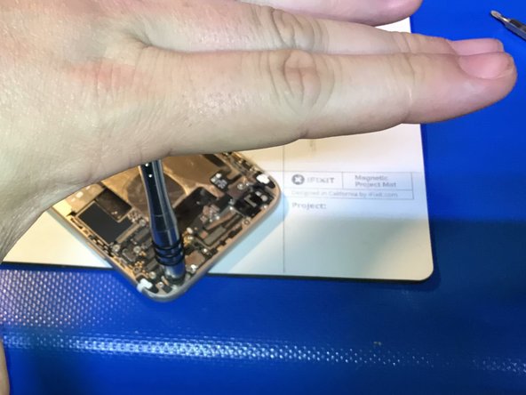

    • Before disassembling your iPhone, discharge the battery below 25%. A charged lithium-ion battery can catch fire and/or explode if accidentally punctured.
    • Power off your iPhone before beginning disassembly.
    • Remove the two 3.4 mm P2 Pentalobe screws on the bottom edge of the iPhone, on either side of the Lightning connector.

    I can’t the screws with the P2, seems that the screws are stuck, what can i do?

    i have replaced several ipod batteries and laptop work, but these screws seem to loose but do not come out. how am i to remove them.shake the iphone?it seems the ioen is not in my kit, is that how to remove them?

    My screws aren’t coming out either. I’ve loosened them, but they aren’t coming out. I’ve shaken the phone, given it some slight bangs…nothing.

    The P2 is not getting the screws loose at all. I have tried this several times and no budge on my iPhone 6s.

    I found a pentalobe 1 driver to work much better.

    First step problem? Couldn’t get the screws out. I checked my other iPhone and realized the screws were missing!Just started prying it apart.

    SavvyCat - crwdns2934203:0crwdne2934203:0
    A packing tape handle worked well for me instead of the suction cup. I folded a piece of packing tape in half leaving two ends to stick to the part of the screen indicated for the suction cup placement and used the center fold as a handle.
    Diana Riddle - crwdns2934203:0crwdne2934203:0
    I found that a 3rd hand helped here. Lots of heat and as others say, a strong, steady pull, but you are only creating a gap to get the spludger in, not ripping the screen away from the body. Once I created the teeny gap I had someone else get the spludger in to hold it open while I shifted my grip.
    Steve - crwdns2934203:0crwdne2934203:0
    I’ll throw in here for other noobs as someone who just read ALL the comments and had things go pretty well without a hitch.
    Adhesive here goes ALL the way around edge. I think think many people’s frustration comes from in adequate heating and/or only heating the inferior edge area. I went with 5 min of a rice/shoulder thingy, (uniform rectangle folded in half on a plate, 3 min in the microwave) Plate side was hot potato hot and stayed so.
    Other inference and comment curating:
    a. Use pointy spudger end inserted slightly into headphone jack to hold down phone while pulling up;
    b. 2mm lift MAX the insert something to hold while you bring the flat end of the spudger around (I just used the flesh of my finger;
    c. Twist spudger ONLY zero -20 degrees when inserted;
    d. Avoid spudgering above or between the pentab screw holes.
    e. Avoid sticking the spudger in more than 2 mm as you slide up the left and right edges. If you catch, back it out a bit until you can keep sliding.
    Aaron - crwdns2934203:0crwdne2934203:0
    Also all props to Ifixit for addressing many issues with earlier versions of this and their replacement kit! A lot of complaints are clearly obsolete now.
    And if this your first time block out an afternoon and be glad if it only takes 20-30 minutes. Rushing causes breakage more often than not.
    I’m in a third world country without access to a hairdryer. Is there anyway else to loosen the adhesive?
    Dylan - crwdns2934203:0crwdne2934203:0
  4. iPhone 6s Camera Ring Replacement: crwdns2935265:04crwdnd2935265:01crwdnd2935265:02crwdne2935265:0 iPhone 6s Camera Ring Replacement: crwdns2935265:04crwdnd2935265:02crwdnd2935265:02crwdne2935265:0
    • Pull up on the suction cup with firm, constant pressure to create a slight gap between the front panel and rear case.
    • Take your time and apply firm, constant force. The display assembly is a much tighter fit than most devices and is held down with adhesive.
    • Pulling too hard may damage the display assembly. Apply just enough pressure to create a small gap between the display assembly and the rear case.
    • If you have any trouble, heat the front of the iPhone using an iOpener, hair dryer, or heat gun until it's slightly too hot to touch. This will help soften the adhesive securing the edges of the display.
    No, really. Do this on a table and use less strength than you think. If you open the display the whole way at this step you can easily rip the home button connections and one of several display connections at the top. <— too much experience... :(
    chuymatt - crwdns2934203:0crwdne2934203:0
    Wow, that was tough. Patience, patience, patience. Did not use the iOpener, just firm and consistent pulling with the phone on a flat surface. When the suction cup comes off... clean the display surface and go back at it. I did use the pointed end of a spudger inserted into the headphone jack to hold down the bottom case whilst I pulled on the suction cup. Once there was sufficient room (see next step) you can just get the spudger (flat end) to slide in slightly.
    plisi - crwdns2934203:0crwdne2934203:0
    If you're lifting up on the glass, how are you supposed to hold the rest of the phone down? Is it by holding the camera end down with the side of your hand and rotating your hand, or using your other hand (not pictured) on the edges (seems very difficult), or using a spudger in a jack?
    Bryan - crwdns2934203:0crwdne2934203:0
    I got a fingernail on the metal edge and that did the trick.
    David Heinbach -
    On the 6s, which has an annoying black adhesive strip holding the display assembly on, I use the iSclack to loosen a very small area near the home button then insert a thin spudger and gently twist it a bit to release the adhesive. Do this around the bottom and both sides of the phone to release the screen. I usually have to break some of the adhesive strands when the opening is big enough.
    scentaur - crwdns2934203:0crwdne2934203:0
    My spudgers just too thick for initial insertion. In the end, fingernail on my thumb got me started, and I was able to get plastic picks in there to work it. The microwavable iOpener gel strip really helped.
    Heidi Moser - crwdns2934203:0crwdne2934203:0
    Thanks plisi, your comments are helpful. I had to apply pressure several different times. Didnt realize until about the seventh time applying pressure that what I was doing was slowly loosening the adhesive. Patience is truly the key with this step. You may not think you're progressing but it's slowly prying away.
    amylofton - crwdns2934203:0crwdne2934203:0
    What happens if the cup won't even stick to the display because it is cracked and it will not hold air near the bottom of the phone?
    Jaredrett - crwdns2934203:0crwdne2934203:0
    hey everyone, i just did my first iphone 6S display...after many 5, 5c, and 5s iphones...just keep trying and carefully insert the spunger where they said...right around the headphone jack. The black adhesive makes it very tough to get it off unless you work at one corner. Be careful...but you can do it! ;-)
    David Althaus - crwdns2934203:0crwdne2934203:0
    Use a razor, and go along the outside of the phone carevilly using the razor as a spudger. it will efficiently cut and weaken the adhesive while spudging the screen away from the frame. only takes 15 mins.... Use a workbench razor, not a flimsy one. If possible, use one where one side of the razor has a gaurd on it for better grip. Take it slow and try not to scratch the frame. Lots of pressure and patience is key!!!
    Goodluck!!
    -J
    The first time you pull it apart there's black glue tape that you'll have to compete with to get it open. Be careful
    Jeff - crwdns2934203:0crwdne2934203:0
    Use a hairdryer about 2-3 inches from the phone on high heat for about a minute, moving the dryer the entire time. The phone opened for me in less than a minute after trying for several minutes without heating up the phone.
    Todd Leach - crwdns2934203:0crwdne2934203:0
    Careful ..delicate work. I also used a hot hair dryer around the perimeter for just a couple minutes to help loosen the adhesive bond. I then used my sadly short finger nail to help loosen the edge. I placed dental floss under the corner & carefully lifted the display very very slowly. This worked within about 3 minutes. As mentioned earlier the adhesive used in the iPhone 6s is very strong but this routine worked like a charm & was quick!
    Mary Blocher - crwdns2934203:0crwdne2934203:0
    Much easier to do using the Spudger that is provided in the Pro Tool Kit. It has a thinner fin type head. The Spudger provided in this repair kit is definitely too thick and makes it far more difficult.
    Tyler Brady - crwdns2934203:0crwdne2934203:0
    The spudger is too thick and the glue is too strong. Pulling up broke the glass below the power button. Now I am out $200 for a repair, plus a battery. Bummer. I am VERY good at repairing things. The adhesive on this is very very strong. The pentalobe tip that they send with the kits not milled well and I had to take a file and flatten the tip to get it to work - it is not finished well at all. I used the kit for the iPhone 6 for my Mom and had no problem. I am 51 and have been fixing things since I was very young.
    greghabiby - crwdns2934203:0crwdne2934203:0
    Well, I shattered my screen trying to do this. So now I need a battery and screen repair. Not happy.
    Carolann Parran - crwdns2934203:0crwdne2934203:0
    Me too! Be gentle!
    Matthew Simoenau -
    Me as well, I went very slowly, was working the spudger around the edge and then it shattered. Just going to buy a replacement phone and I was replacing the battery to gift this to my sister as a hand-me-down and now it’s not worth it. Perhaps I can sell the kit second hand…
    kpederso -
    Removing the display was the hardest part of the whole job. The adhesive is very strong, but just be patient. What I ended up doing was to use the suction cup, the flat end of the spudger, and an iFixit opening tool. I used the suction cup on the screen as directed. Then I placed the flat end of the spudger just a bit into the charging port and held down the phone body by the spudger on my work mat. I pulled up on the suction cup, pushed down on the spudger, and inserted the thin iFixit opening tool in the small seperation. I took my time and worked my way around all of the edges. After that it was really easy. I was able to reuse the adhesive, and my new battery install went just as planned.
    Eric Olson - crwdns2934203:0crwdne2934203:0
    Use a hair dryer as per the suggestions and this will definitely make the job easier and reducing the risk of breaking the display . Keep a steady pull of the display, don’t rush and it will start to show the small separation gap. An issue is that it will go back in place if you stop pulling before you can use the spudger tool. The suction tool that came with my repair kit did not have a ring on it as per the guide picture. It has a blue handle that is open on the side. I sat at my kitchen desk and opened a drawer. I hooked the open edge of the suction handle around the drawer side edge which me a third hand. I held the phone with one hand and pulled it away from the desk drawer. Once the separation started I could use my other hand with the flat edge of the spudger to complete the separation. Hope this helps.
    emaneht - crwdns2934203:0crwdne2934203:0
    Hair dryer - 1 minute until it’s hot like a fresh mug of coffee. Then as soon as you see the smallest gap, insert a razor blade above the phones jack, I needed to slide it towards the charge port and back. Once it slips in keep it there and use your spudger to enlarge the gap and slide it along the corners.
    Steve Esson - crwdns2934203:0crwdne2934203:0
    Yes, I used the tip of a sharp knife as a pry tool to get me started. Since the screen was cracked anyway I figured I had nothing to lose. It went fine.
    David Heinbach -
    Also tried it with the hair dryer - worked like a charm. 5 Minutes and the phone was open. The whole repair procedure took me about 45 minutes, and was ok. Re-assembling the three display-connectors has been a bit tricky, but with careful movements and taking the time it needs it was not a big problem. New display is very good, phone looks like new :-)
    Christian Woelk - crwdns2934203:0crwdne2934203:0
    My glass was broken and the suction cup wouldn’t hold on the tape. I used a very thin knife an slowly worked between the glass and the phone frame. Please keep in mind that my phone had been run over by a Ford F150, so I really had nothing to lose.
    Michael Cleveland - crwdns2934203:0crwdne2934203:0
    What is unfortunately unclear is just how to 1. apply sufficient force and keeping the phone secure with only one hand, 2. whether this is best done on a table to use its opposing surface to secure the phone.
    The suction cup is a worthless tool because flexes too much to provide a good hold. Mine slipped and popped away three times. -The last time causing a crack in the screen.
    ffissk - crwdns2934203:0crwdne2934203:0
    Glad I read these comments about the screen cracking because I was really trying to force this thing open (with some heat applied already), but it wasn’t budging. Kept applying heat and light force and eventually it started coming apart. The suggestion for placing the pointed end of the spudger in the headphone jack while prying up worked for me and an extra set of hands would have been ideal.
    In the end, with the spudger in the headphone jack, placed a guitar pick in between the screen and the backing and slid it along the bottom left. Left the tip of the guitar pick in to hold the gap and then was able to use the spudger to complete the process as shown.
    Nicholas Anchor - crwdns2934203:0crwdne2934203:0
    Beware! I cracked the screen. Used iOpener, iFixit spudger etc. I managed to get the spudger into the gap by the headset socket and worked my way up the left, when I came to do the right the screen was cracked. I was taking it slow and steady but clearly that wasn’t enough. Be VERY careful.
    James - crwdns2934203:0crwdne2934203:0
    Heat is essential, and take it very slowly. Also take seriously the instruction to open just enough to get the spudger in there—then do the real work with that. The suction is just to get started. I had my son insert the spudger as soon as there was any gap at all, then worked it according to the guide.
    I did this on a card table with a vinyl surface so I could lay the phone down. Then I held the metal frame on both sides while pulling the suction cup—my son having the spudger at the ready. Definitely be patient! I had to restart several times when the suction cup popped off and I accidentally reengaged the clips pressing it back on.
    Matt Burleson - crwdns2934203:0crwdne2934203:0
    I didn’t have any of the heating tools listed here so I improvised:
    To soften the glue I heated water in a pan (not boiling but quite hot).
    I put the phone in a thick plastic bag in the water for about 20 - 30 seconds. (I checked the bag was properly watertight first by dipping it in water – minus the phone). Maybe I was lucky but the screen came away easily doing it this way.
    Henrik Dahle - crwdns2934203:0crwdne2934203:0
    I did the hair dryer three or four times and applied all of the pressure i could on the suction cup and it just wouldn’t budge. My phone is old and i had a waterproof case on it for a long time that really pressed down on the glass so it would seal. I think having that on for three or more years really sealed the glass!!!! Didn’t want to break it so will live with my battery as is…..it last most of the day and i am usually around a car charger or home. Just thought i would add a comment that said man i gave it my best shot and opted not to do it. I really liked the kit though and the tool will come in pretty handy to repair other small things.
    David Petr - crwdns2934203:0crwdne2934203:0
    This was waaaaay the hardest bit for me. Took ages Almost gave up. Allow AT LEAST twenty minutes. Endless patience pulling, then resting for a bit then pulling again. S.T.E.A.D.Y Keep at it long after your inner voice is saying ‘why did you think you could do this. You have never mended anything in your life.’ Then you see the gap and like a steady bomb disposal expert you quietly winkle it apart.
    Cindy Clarke - crwdns2934203:0crwdne2934203:0
    Used heat from a hairdryer, gentle pulling to lift the glass at the position above the headphone jack one to 2 millimetres with the suction cup, then put my thumbnail in the gap and pulled up gently a bit more to fit the spudger, and mainly slid the spudger as indicated around the glass, bottom first, and then sides to within about a centimetre of the top at most, to release the display. I found very little prying is needed. Once a gap of about a millimetre or 2 is created, that is enough to release the display from the adhesive.
    Nando - crwdns2934203:0crwdne2934203:0
    Run a little isopropanol along the seam at the bottom end (I had no syringe, so I dipped the handle end of a spoon in and ran that along). Leave a couple of minutes, then warm with a hair drier. It will pop right off with the suction cup.
    robthebrew - crwdns2934203:0crwdne2934203:0
    It was so much easier after I removed the two screws from step one… LOL! With heat, the screen should come up quite easily. You definitely don’t want to pull too hard. I introduced a small illumination artifact into the screen where the suction cup was attached. I’m not sure whether this was due to the suction cup or excessive heat. I was using a heat gun and trying to warm the screen evenly so it wouldn’t crack. But the temp might have been too high. Next time I’ll just heat the metal around the edges.
    len - crwdns2934203:0crwdne2934203:0
    don’t forget the screws like my stupid self did!!!
    trevorsklar - crwdns2934203:0crwdne2934203:0
    After 45 minutes of using a hair dryer the entire time while suction cupping it some 50 times (kept popping off), I finally was able to create the gap needed to remove the display. I found steady pulling of the suction cup was useless. I had to quickly pull,release,pull,release,repeat and this nudged the tape apart, which had the constancy of dried superglue. Not easy, but this phone was 7 years old,....
    skypilota72 - crwdns2934203:0crwdne2934203:0
    Got this done in about 2 minutes!! I used a space with that had a fan function. Held up my phone to it for a few minutes, also heated up the suction cup. I didn't have extra help, so the whole "pull suction cup with left hand, hold down phone by headphone jack with right hand, and insert pick with ??? hand" wasn't going to work. I was able to hold the phone down while also pulling up on the suction cup all with my left hand (almost like i was peeling the screen up). Stuck a plastic Opening Pick in the small opening, then slid in the flat end of a spudger. I could not rotate the spudger like in the photo (photo 2 of step 6), the screen was stuck on too tight, so I just started sliding the thin end of the spudger around. I held the phone up in front of the heater during this. I also used the pick to cut adhesive along the way.
    Kelly Archer - crwdns2934203:0crwdne2934203:0

  13. iPhone 6s Camera Ring Replacement, Battery Connector: crwdns2935265:013crwdnd2935265:01crwdnd2935265:01crwdne2935265:0
    Magnetic Project Mat
    $19.95
    • Remove two Phillips screws securing the battery connector bracket, of the following lengths:
    • One 2.9 mm screw
    • One 2.2 mm screw
    • Throughout this repair, keep track of each screw and make sure it goes back exactly where it came from to avoid damaging your iPhone.
    In order to put the correct screw back where you took it out mark the head surface and a small dot beside the hole with a pen. Use coloured pens if you want the exact location for each screw/hole. This goes for steps 17, (23) and 29 too.
    lionno1 - crwdns2934203:0crwdne2934203:0
    Please! Please! Please! Invest in a Magnetic Project Mat or its equivalent from fixit. It will assist you with completing your repair.
    Ian Baldwin - crwdns2934203:0crwdne2934203:0
    I just taped down a 8.5 x 11 white piece of paper on my desk and drew a rough image of it, then ‘taped’ the screw I removed to the “image” on paper. It worked just fine. (My first time ever opening an iphone, so give it a shot!)
    italianchick99 - crwdns2934203:0crwdne2934203:0
    If you missed it from the beginning (like I did) it’s the #000 Philips for all screws except the Pentalobes.
    Max Cox - crwdns2934203:0crwdne2934203:0
    if you get a plastic ice cube tray, and a fine marker pen, text the sizes on each cube compartment as you follow the guide, also stops the screws getting lost
    Brendan Cranny - crwdns2934203:0crwdne2934203:0
    used sheet of A4 paper and bluetak - stick screw in bluetak, write location & size on paper
    Kev Salmon - crwdns2934203:0crwdne2934203:0
    mine is missing a screw!!! this is bs! this was mynmithers ohone nonone ooened it….one screw only…im liesed offf
    makinfilms - crwdns2934203:0crwdne2934203:0

    For removing screws, I used a piece of paper and sketched the screw locations and screw sizes in the appropriate pattern for each step I was working on removing screws. I folded clear packing tape in a loop so some sticky area was on top for each screw so they did not fly away when the hair dryer was on or in case I knocked the paper while working beside it. This kept all the screws in an easy pattern with descriptions for later install. Worked slick.

  29. iPhone 6s Camera Ring Replacement, Removing the ring: crwdns2935265:029crwdnd2935265:01crwdnd2935265:01crwdne2935265:0
    • Butt the lens rim up against a raised surface with the rest of the phone on the surface and the ring over air.
  30. iPhone 6s Camera Ring Replacement: crwdns2935265:030crwdnd2935265:01crwdnd2935265:02crwdne2935265:0 iPhone 6s Camera Ring Replacement: crwdns2935265:030crwdnd2935265:02crwdnd2935265:02crwdne2935265:0
    • Use a driver without a bit to fit on the ring from the inside. It shouldn't rest on the frame around the ring at all. Gently tap down on the ring until it pops out while firmly holding the frame down.
    If you don’t have a driver that fits, a punch and hammer works well. Just make sure you are on the lip of the camera glass frame and not the iPhone frame.
    iHelpU.Tech - crwdns2934203:0crwdne2934203:0
