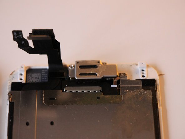

  3. iPhone 6 Teardown, Remove the screen: crwdns2935265:03crwdnd2935265:01crwdnd2935265:03crwdne2935265:0 iPhone 6 Teardown, Remove the screen: crwdns2935265:03crwdnd2935265:02crwdnd2935265:03crwdne2935265:0 iPhone 6 Teardown, Remove the screen: crwdns2935265:03crwdnd2935265:03crwdnd2935265:03crwdne2935265:0

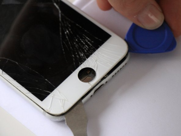

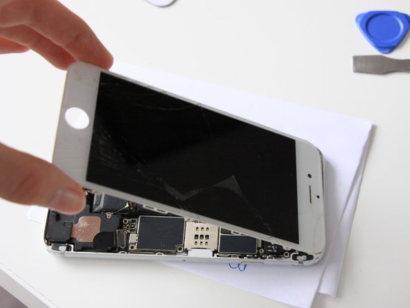

    • Remove the screen
    • Lift the screen with the suction cup.
    • Then remove it further by using the opening picks.
    • Now remove the entire screen by lifting it from below with your hand.

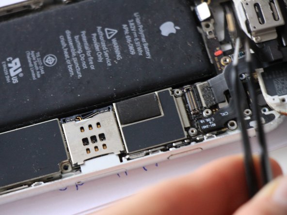

  4. iPhone 6 Teardown, Disconnect the connectors: crwdns2935265:04crwdnd2935265:01crwdnd2935265:03crwdne2935265:0 iPhone 6 Teardown, Disconnect the connectors: crwdns2935265:04crwdnd2935265:02crwdnd2935265:03crwdne2935265:0 iPhone 6 Teardown, Disconnect the connectors: crwdns2935265:04crwdnd2935265:03crwdnd2935265:03crwdne2935265:0
    • Use the antistatic tweezer to detach the connectors.
    • You now see four connectors. Two for the screen, one for the selfie camera and one for the home button.
    • The connector for the home button is in a strange place here. These connectors are located at the top of the screen, while the button itself is at the bottom. To save space, they should place it much closer to the button. Especially since you can conclude from the connector of the SIM card that it is possible to place connectors in various places
  5. iPhone 6 Teardown, View the inside: crwdns2935265:05crwdnd2935265:01crwdnd2935265:02crwdne2935265:0 iPhone 6 Teardown, View the inside: crwdns2935265:05crwdnd2935265:02crwdnd2935265:02crwdne2935265:0
    • Now you can look at the device from the inside.
    • I noticed a lot of dust. This is because this IPhone is not yet waterproof. This also makes the dust come in easily.
    • I als noticed that the device is not only built in 2D but also in 3D. They probably did this to save space.

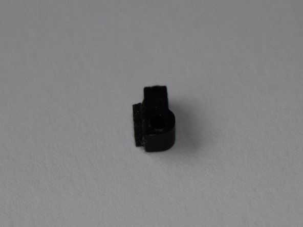

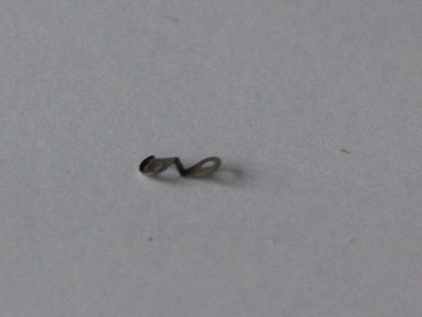

    • At first I thought that the rubber was not important, but keep these parts well.
    • These rubber pieces ensure that electricity is not conducted in certaint places. It also ensures that all parts fit together precisely

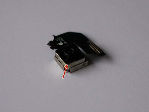

  7. iPhone 6 Teardown, Take the camera apart: crwdns2935265:07crwdnd2935265:01crwdnd2935265:03crwdne2935265:0 iPhone 6 Teardown, Take the camera apart: crwdns2935265:07crwdnd2935265:02crwdnd2935265:03crwdne2935265:0 iPhone 6 Teardown, Take the camera apart: crwdns2935265:07crwdnd2935265:03crwdnd2935265:03crwdne2935265:0

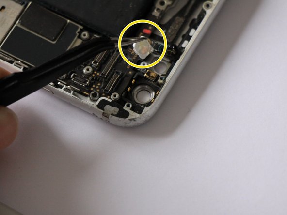

    • The camera is located at the top richt.
    • Loosen the screw with a screwdriver and remove the screw with an antistatic tweezer.
    • At first I thought I broke the camera, because the camera was moving ; red in the image. Later I found out that this was a stabilizer. It moves in the exact opposite direction of your shacking hands. In this way the image remains clear.
    • Next to the camera you will find the camera flash. I expected it to be way bigger. It is super small, but it still produces a large amount of lightning (yellow in the image).
