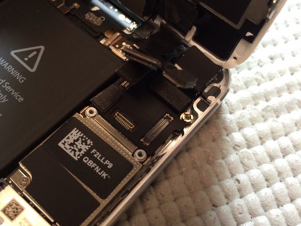

      • After using spudger or suction cup to lift screen. Be careful not to pull screen completely up. The touch id sensor flex cable is attached near the home button. There is a small metal clip that needs to be carefully pry'd off before removing flex cable connector.

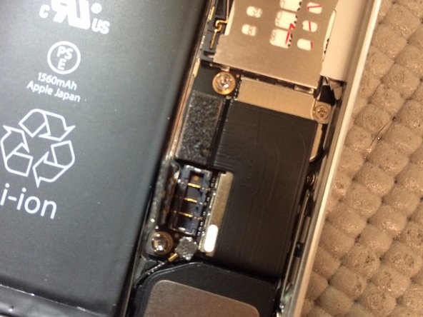

      • Disconnect battery before screen removal by removing 2 screws from shield. Once shield is removed, disconnect battery using nylon spudger. (DO NOT USE METAL TOOLS)

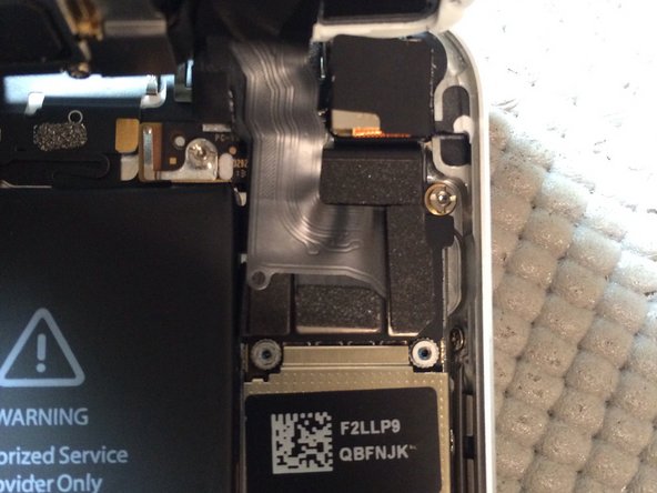

      • Remove four screws from shield covering display assembly connectors. Lift connectors using nylon spudger.
Swap all parts from old display assembly to new assembly. Do not remove all at once, replace components one at a time. To reassemble your device, follow these instructions in reverse order.
