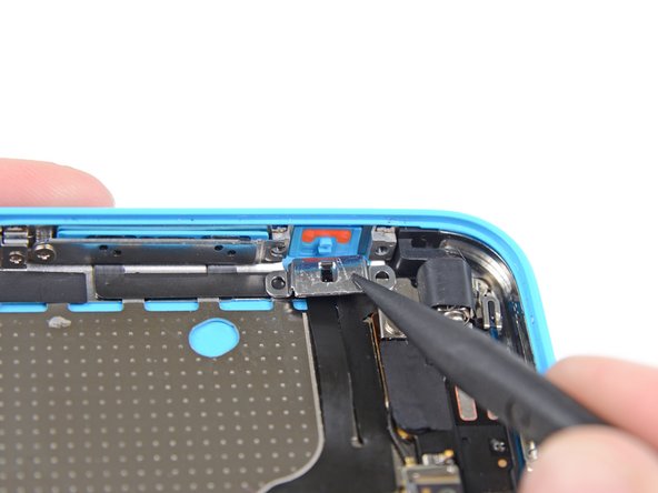

  28. iPhone 5c Volume Controls Replacement, Volume Controls: crwdns2935265:028crwdnd2935265:01crwdnd2935265:01crwdne2935265:0
    • Remove the two 1.6 mm Phillips #000 screws from the hold switch bracket.
  29. iPhone 5c Volume Controls Replacement: crwdns2935265:029crwdnd2935265:01crwdnd2935265:02crwdne2935265:0 iPhone 5c Volume Controls Replacement: crwdns2935265:029crwdnd2935265:02crwdnd2935265:02crwdne2935265:0
    • Remove this hold button bracket clip and set it aside.
    • During reassembly, ensure the angled portion is to the right.
    • Use the tip of a spudger to flip the hold switch bracket down.

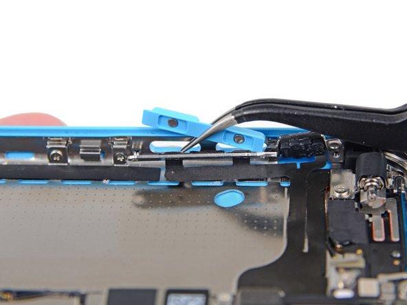

  30. iPhone 5c Volume Controls Replacement: crwdns2935265:030crwdnd2935265:01crwdnd2935265:01crwdne2935265:0
    • Use tweezers to remove the hold switch.
    • Note the orientation for reassembly: The red line should be at the top of the button. The notch in the back of the hold switch button should be in the same position as, and mate with, the mechanical switch on the cable.
  31. iPhone 5c Volume Controls Replacement: crwdns2935265:031crwdnd2935265:01crwdnd2935265:01crwdne2935265:0
    • Remove the 1.6 mm Phillips #000 screw securing the volume rocker bracket to the side wall.
  32. iPhone 5c Volume Controls Replacement: crwdns2935265:032crwdnd2935265:01crwdnd2935265:02crwdne2935265:0 iPhone 5c Volume Controls Replacement: crwdns2935265:032crwdnd2935265:02crwdnd2935265:02crwdne2935265:0
    • Use the tip of a spudger to fold the volume rocker bracket down from the side wall.
    • Remove the volume rocker.
