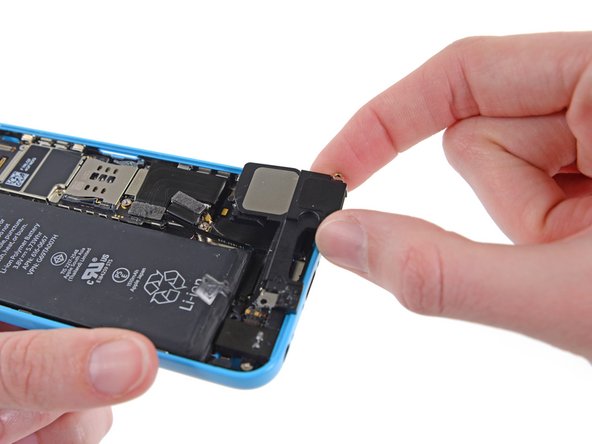

    3. iPhone 5c Speaker Replacement: crwdns2935265:019crwdnd2935265:01crwdnd2935265:02crwdne2935265:0 iPhone 5c Speaker Replacement: crwdns2935265:019crwdnd2935265:02crwdnd2935265:02crwdne2935265:0
      • Use the flat end of a spudger to gently pry the speaker enclosure up from the rear case.
    4. iPhone 5c Speaker Replacement: crwdns2935265:020crwdnd2935265:01crwdnd2935265:03crwdne2935265:0 iPhone 5c Speaker Replacement: crwdns2935265:020crwdnd2935265:02crwdnd2935265:03crwdne2935265:0 iPhone 5c Speaker Replacement: crwdns2935265:020crwdnd2935265:03crwdnd2935265:03crwdne2935265:0
      • Remove the speaker enclosure. Be careful not to snag it on the antenna cable.

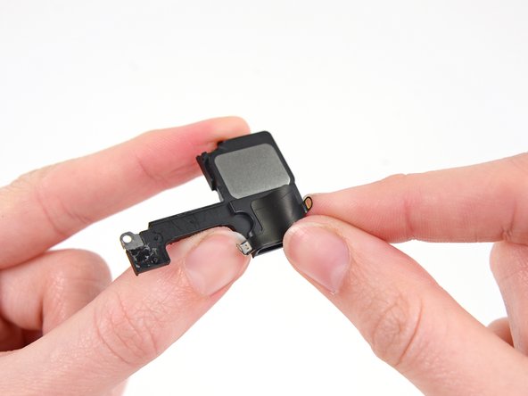

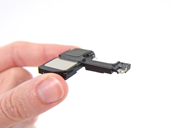

    5. iPhone 5c Speaker Replacement: crwdns2935265:021crwdnd2935265:01crwdnd2935265:02crwdne2935265:0 iPhone 5c Speaker Replacement: crwdns2935265:021crwdnd2935265:02crwdnd2935265:02crwdne2935265:0
      • The far right screw hole on the speaker has a contact bracket wrapped around it. Remove it and note the orientation for reassembly.
      • The flat portion of the contact clip should rest against the speaker, as shown.
      • The alignment bracket on the far end of the speaker assembly is adhered, but may fall off if handled aggressively.
      • The angled end should face up and line up with the outside edge of the speaker.
    6. iPhone 5c Speaker Replacement: crwdns2935265:022crwdnd2935265:01crwdnd2935265:02crwdne2935265:0 iPhone 5c Speaker Replacement: crwdns2935265:022crwdnd2935265:02crwdnd2935265:02crwdne2935265:0
      • Your replacement speaker may be missing the contact-bearing sticker shown here; be sure to transfer it to the new part.
      • Use a plastic opening tool to lift the sticker from the speaker.
      • Peel up and remove the sticker.
