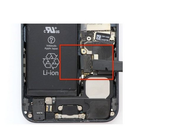

    • Note: While disconnecting the battery, you will have to hold the Display assembly upward with one hand, while removing the screws and retaining plate with the other hands.
    • Remove three Phillips screws:
    • 1x 1.8 mm Phillips Screw 1x 1.6 mm Phillips screw and 1x 1.2 mm Phillips screws
    • Be careful to only pry up the battery connector and not to pry up the socket on the logic board. If you pry up on the logic board socket, you may break the connector entirely.

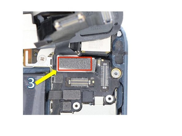

  5. iPhone 5 Dock Connector Replacement FR, Removing the EMI shield: crwdns2935265:05crwdnd2935265:01crwdnd2935265:02crwdne2935265:0 iPhone 5 Dock Connector Replacement FR, Removing the EMI shield: crwdns2935265:05crwdnd2935265:02crwdnd2935265:02crwdne2935265:0

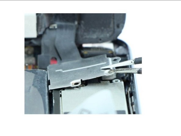

    • Remove the three Phillips screws securing the EMI shield to the logic board. ( The upper right screw is an aluminum screw which makes it non-magnetic. )
    • Two 1.2mm Phillips Screws
    • 1x 1.6mm Phillips non-magnetic Phillips Screws
    • In order to remove the EMI shield, slightly lift it upward at an angle using tweezers, then slide the EMI shield toward the battery and remove it.

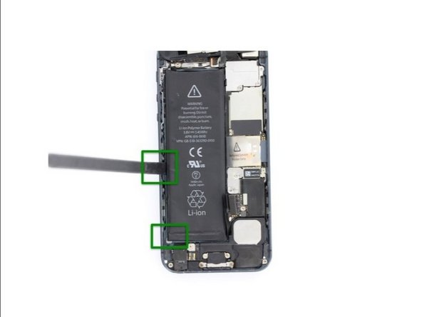

  7. iPhone 5 Dock Connector Replacement FR, Pulling the battery out: crwdns2935265:07crwdnd2935265:01crwdnd2935265:02crwdne2935265:0 iPhone 5 Dock Connector Replacement FR, Pulling the battery out: crwdns2935265:07crwdnd2935265:02crwdnd2935265:02crwdne2935265:0
    • Gently pull the battery pull-tab ti remove the battery from the frame.
    • NOTE: The battery is held in place with adhesive, Heat the back of the frame a little bit and use a nylon spludger to help you lift the battery off the frame.
    • Safe Area to pull are marked in GREEN.
    • If you haven't already done it at this point, remove the sim card tray from the iPhone as well.

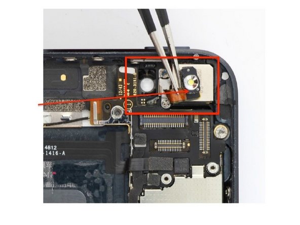

    • Starting at the top of the phone, remove the two Phillips screws holding the camera flash retaining plate.
    • 1x 1.5mm Phillips Srew (RED)
    • 1x 2.3mm Phillips Screw ( Green)
    • Use tweezers to carefully fold the flash flex cable upward.
    • NOTE: The metal box that the flash module rests in will usually stay adhered to the cable. Should they separate, set aside the metal housing for later installation.

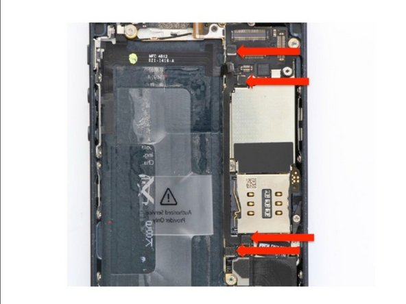

  9. iPhone 5 Dock Connector Replacement FR, Disconnect some cables: crwdns2935265:09crwdnd2935265:01crwdnd2935265:03crwdne2935265:0 iPhone 5 Dock Connector Replacement FR, Disconnect some cables: crwdns2935265:09crwdnd2935265:02crwdnd2935265:03crwdne2935265:0 iPhone 5 Dock Connector Replacement FR, Disconnect some cables: crwdns2935265:09crwdnd2935265:03crwdnd2935265:03crwdne2935265:0

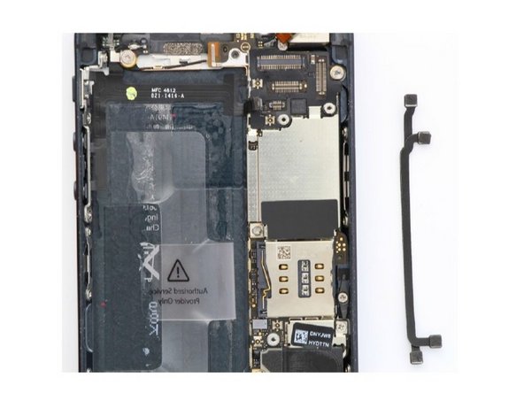

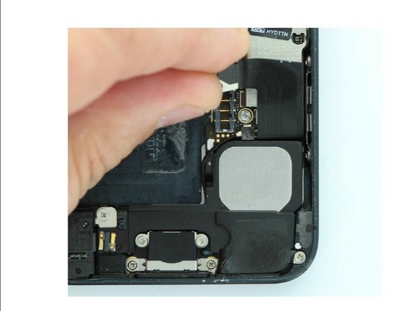

    • Start by disconnecting the power/audio control cable from the logic board.
    • Then, Go after the inter-connect cable boards using the pointed end of a spludger.
    • Note: the inter-connect cables are stuck together with an adhesive. It's normal if they separate during removal. The straight cable is for cellular diversity, which, if faulty, impacts cellular reception and download speeds. The cable with two curves is for GPS. Without this cable, navigation will not work.

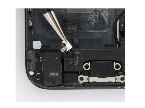

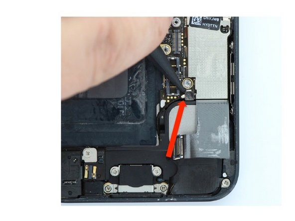

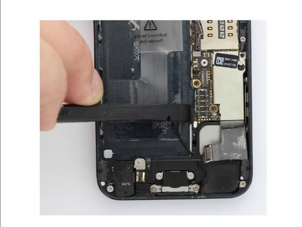

    • Disconnect the dock connector cable connector from the board using the pointed end of the nylon spudger as shown.
    • Peel the dock connector cable from the logic board.
    • Disconnect the cellular service antenna using the pointed end of the nylon spudger under the metal clasp.

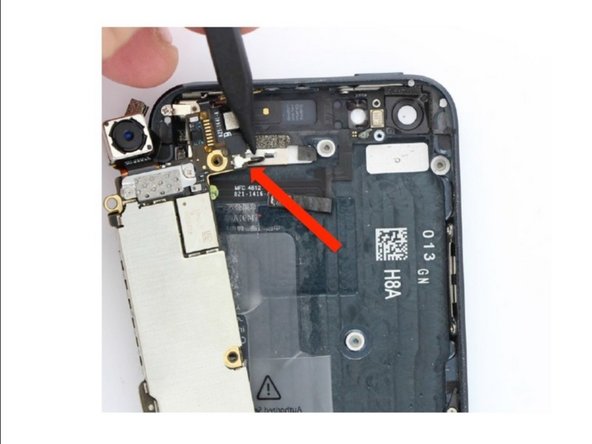

    • At the top of the frame, remove the two 1.3mm Phillips screws holding the cellular service and GPS antenna's against the frame.

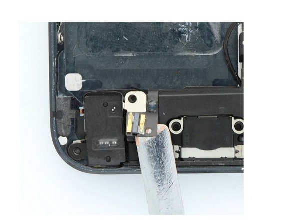

    • Peel both the home button connector and audio jack filter ground from the loud speaker.
  14. iPhone 5 Dock Connector Replacement FR, Removing everything: crwdns2935265:014crwdnd2935265:01crwdnd2935265:03crwdne2935265:0 iPhone 5 Dock Connector Replacement FR, Removing everything: crwdns2935265:014crwdnd2935265:02crwdnd2935265:03crwdne2935265:0 iPhone 5 Dock Connector Replacement FR, Removing everything: crwdns2935265:014crwdnd2935265:03crwdnd2935265:03crwdne2935265:0

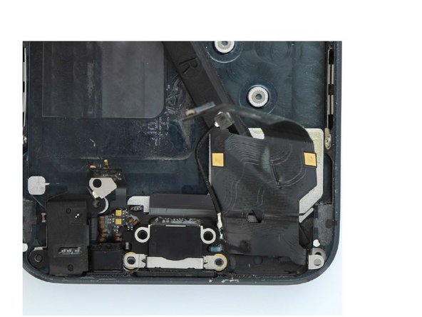

    • Remove the loud speaker from the frame.
    • Peel back the dock connector cable from the frame.
    • Dot not loose the four spring washers underneath the lightning port housing.

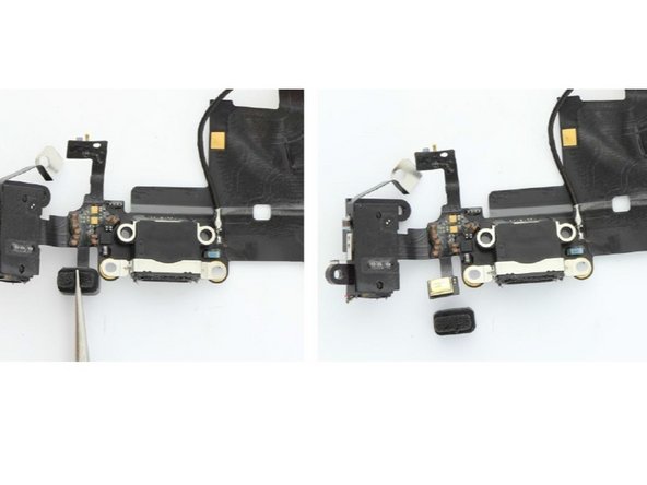

    • Pull the rubber boot off the lower microphone area of the dock connector cable.
    • Carefully peel the headphone jack filter off the headphone jack housing.
  15. iPhone 5 Dock Connector Replacement FR, Finish: crwdns2935265:015crwdnd2935265:01crwdnd2935265:01crwdne2935265:0
    • NOTE: BE CAREFUL not to rip or tear the filter!
    • Be sure to transfer all foams pad to the new dock connector assembly if necessary. Good luck ! :)
