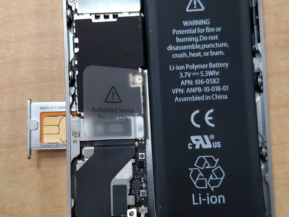

    13. iPhone 4S Power button Replacement: crwdns2935265:013crwdnd2935265:01crwdnd2935265:02crwdne2935265:0 iPhone 4S Power button Replacement: crwdns2935265:013crwdnd2935265:02crwdnd2935265:02crwdne2935265:0
      • Use a paper clip to eject the sim card and put it in a safe place
