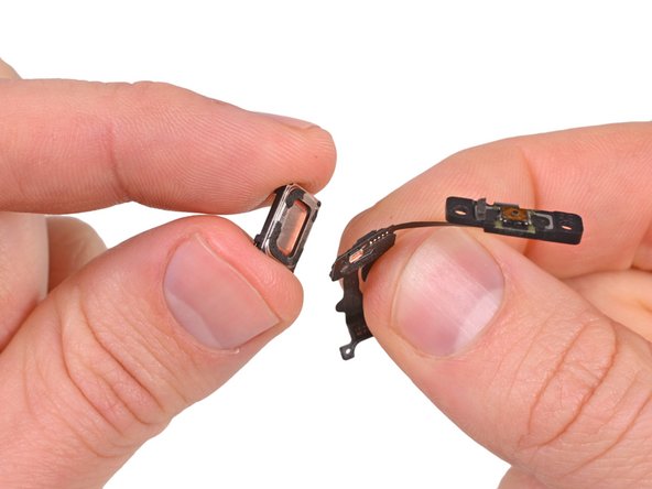

  32. iPhone 4S Power and Sensor Cable Replacement, Power and Sensor Cable Assembly: crwdns2935265:032crwdnd2935265:01crwdnd2935265:02crwdne2935265:0 iPhone 4S Power and Sensor Cable Replacement, Power and Sensor Cable Assembly: crwdns2935265:032crwdnd2935265:02crwdnd2935265:02crwdne2935265:0
    • Use the edge of a plastic opening tool to pry the earpiece speaker off the adhesive securing it to the outer case. Note that the power button cable is glued to the the case as well, and will need to be pried up.
    • Use a pair of tweezers to unfold the earpiece speaker from its recess in the outer case.
    • Be careful not to tear the cable from the earpiece speaker. They are adhered together, and the cable is very delicate.
  33. iPhone 4S Power and Sensor Cable Replacement: crwdns2935265:033crwdnd2935265:01crwdnd2935265:02crwdne2935265:0 iPhone 4S Power and Sensor Cable Replacement: crwdns2935265:033crwdnd2935265:02crwdnd2935265:02crwdne2935265:0
    • Use the edge of plastic opening tool to gently move the top sensor assembly away from the outer case.
    • Gently pry the top sensor assembly off the outer case.
  34. iPhone 4S Power and Sensor Cable Replacement: crwdns2935265:034crwdnd2935265:01crwdnd2935265:03crwdne2935265:0 iPhone 4S Power and Sensor Cable Replacement: crwdns2935265:034crwdnd2935265:02crwdnd2935265:03crwdne2935265:0 iPhone 4S Power and Sensor Cable Replacement: crwdns2935265:034crwdnd2935265:03crwdnd2935265:03crwdne2935265:0
    • Lift and remove the power and sensor cable assembly from the iPhone.

  35. iPhone 4S Power and Sensor Cable Replacement, Earpiece Speaker Assembly: crwdns2935265:035crwdnd2935265:01crwdnd2935265:02crwdne2935265:0 iPhone 4S Power and Sensor Cable Replacement, Earpiece Speaker Assembly: crwdns2935265:035crwdnd2935265:02crwdnd2935265:02crwdne2935265:0
    • Use the edge of a plastic opening tool to peel the earpiece speaker off the foam adhesive securing it to the iPhone.
    • If you wish to reuse the earpiece speaker, try not to tear the foam adhesive that secures it to the iPhone's case.
    • Remove the earpiece speaker.
  36. iPhone 4S Power and Sensor Cable Replacement, Power and Sensor Cable: crwdns2935265:036crwdnd2935265:01crwdnd2935265:01crwdne2935265:0
    • Use the edge of a plastic opening tool to separate the power button contact from its plastic bracket.
  37. iPhone 4S Power and Sensor Cable Replacement: crwdns2935265:037crwdnd2935265:01crwdnd2935265:01crwdne2935265:0
    • Power and sensor cable remains.
