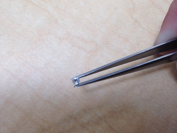

      • Use a 5-point Pentalobe Screw (only for iPhones)to remove the bottom screws on the iPhone 4S. For the Sim Card Holder, there will be a small hole which you can use a remover tool, (or paper clip, which is not the safest tool to use), but will require a fair amount of force for pushing into the hole get the holder out.

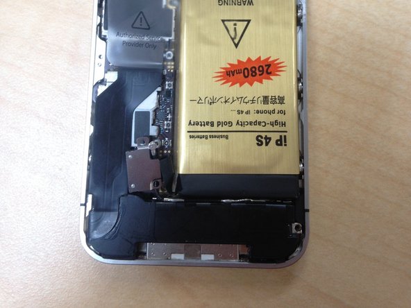

    4. iPhone 4S Logic Board Removal, Battery Removal: crwdns2935265:04crwdnd2935265:01crwdnd2935265:01crwdne2935265:0
      • You’ll automatically see the battery when taking of the back glass(will show a recycle sign and Li-ion written across).There is a plastic tab for you to use to help carefully lift the battery out of the phone (The battery has a connected wire to it, but it can be easily disassembled).

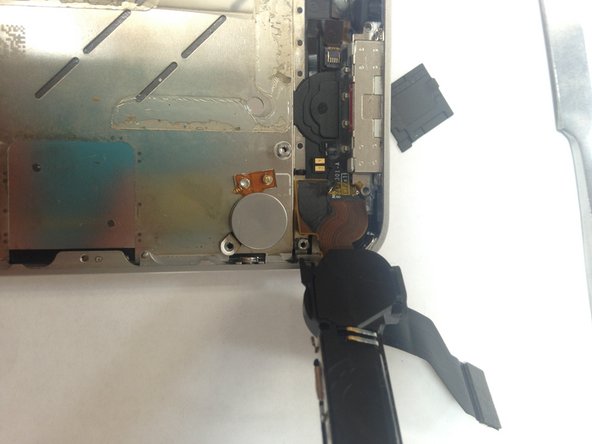

    5. iPhone 4S Logic Board Removal, Camera Removal: crwdns2935265:05crwdnd2935265:01crwdnd2935265:02crwdne2935265:0 iPhone 4S Logic Board Removal, Camera Removal: crwdns2935265:05crwdnd2935265:02crwdnd2935265:02crwdne2935265:0
      • This is where you’ll need your spudger, this will help you lift and disconnect your camera as well as other connectors which you can remove with tweezers (delicate part). With your spudger, you will go under the connector in order to lift and remove the camera from the logic board.

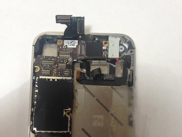

    6. iPhone 4S Logic Board Removal, Logic Board Battery Connector: crwdns2935265:06crwdnd2935265:01crwdnd2935265:02crwdne2935265:0 iPhone 4S Logic Board Removal, Logic Board Battery Connector: crwdns2935265:06crwdnd2935265:02crwdnd2935265:02crwdne2935265:0
      • Use the spudger again for the battery connector that covers the logic board to disconnect.

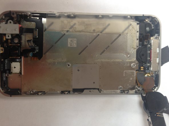

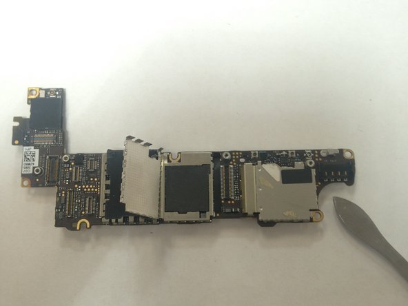

    7. iPhone 4S Logic Board Removal: crwdns2935265:07crwdnd2935265:01crwdnd2935265:03crwdne2935265:0 iPhone 4S Logic Board Removal: crwdns2935265:07crwdnd2935265:02crwdnd2935265:03crwdne2935265:0 iPhone 4S Logic Board Removal: crwdns2935265:07crwdnd2935265:03crwdnd2935265:03crwdne2935265:0
      • Use the ifixit opening tool to remove the screws that hold the logic board in place and lift it with sprudgers in order to completely remove it from the Iphone (This will require some force when lifting the logic board).

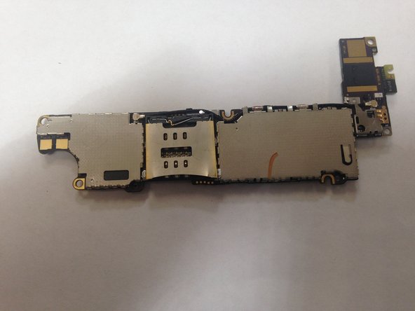

    8. iPhone 4S Logic Board Removal, EMI Shield Removal: crwdns2935265:08crwdnd2935265:01crwdnd2935265:03crwdne2935265:0 iPhone 4S Logic Board Removal, EMI Shield Removal: crwdns2935265:08crwdnd2935265:02crwdnd2935265:03crwdne2935265:0 iPhone 4S Logic Board Removal, EMI Shield Removal: crwdns2935265:08crwdnd2935265:03crwdnd2935265:03crwdne2935265:0
      • There will be the EMI Shields on the logic board (metal on top of the main processing chips) Which a spudger or the opening tool could be used for removal by lifting the small multiple metal tabs on the sides.(This will require a lot of force to lift off the logic board) (May cause a cut if not done without caution)
      • For Reassemble, look up separate instructions or reverse the steps to remove the logic board.
