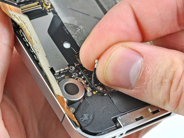

    • Use the edge of a plastic opening tool to pry the Wi-Fi antenna cable up from its socket on the logic board.
    • De-route the Wi-Fi antenna cable out from under the metal fingers attached to the logic board.

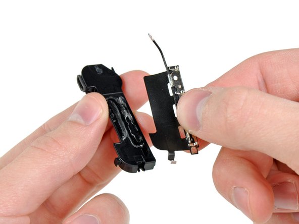

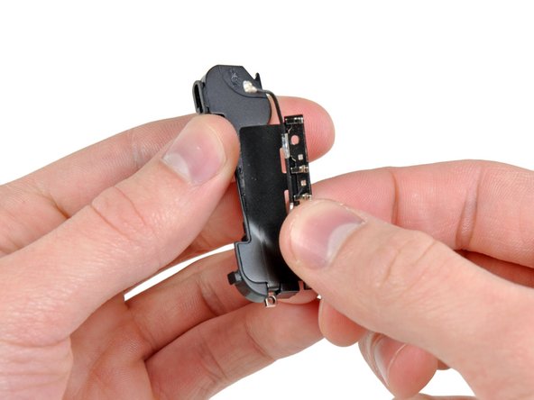

    • Starting near the cellular antenna cable, use the edge of a plastic opening tool to peel the antenna off the speaker enclosure.
    • Continue peeling the cellular antenna off the speaker enclosure, being careful not to rip the gold bracket attached to one of its edges.
    • Remove the cellular antenna.
  17. iPhone 4 Verizon Speaker Enclosure Replacement: crwdns2935265:017crwdnd2935265:01crwdnd2935265:01crwdne2935265:0
    • When installing a new cellular antenna, be sure to slide the gold bracket over the ear molded into the speaker enclosure before sticking the antenna down.
