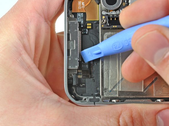

  8. iPhone 4 Verizon Dock Connector Replacement: crwdns2935265:08crwdnd2935265:01crwdnd2935265:01crwdne2935265:0
    • Use the edge of a plastic opening tool to pry the dock cable up from its socket on the logic board.

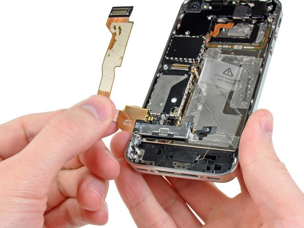

  9. iPhone 4 Verizon Dock Connector Replacement: crwdns2935265:09crwdnd2935265:01crwdnd2935265:01crwdne2935265:0
    • Peel the dock connector cable off the adhesive securing it to the logic board and the side of the speaker enclosure.

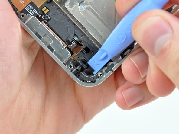

  22. iPhone 4 Verizon Dock Connector Replacement: crwdns2935265:022crwdnd2935265:01crwdnd2935265:02crwdne2935265:0 iPhone 4 Verizon Dock Connector Replacement: crwdns2935265:022crwdnd2935265:02crwdnd2935265:02crwdne2935265:0
    • Use the edge of a plastic opening tool to peel the dock connector and its cable off the black plastic case of the iPhone.
    • If you are replacing the dock connector with a new part, make sure to transfer the rubber casing around the microphone. You can do this using a spudger.
  23. iPhone 4 Verizon Dock Connector Replacement: crwdns2935265:023crwdnd2935265:01crwdnd2935265:02crwdne2935265:0 iPhone 4 Verizon Dock Connector Replacement: crwdns2935265:023crwdnd2935265:02crwdnd2935265:02crwdne2935265:0
    • Pry the dock connector away from its opening at the bottom of the iPhone.
    • Remove the dock connector.
