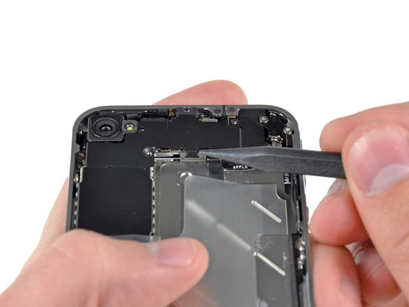

  8. iPhone 4 Rear Camera Replacement: crwdns2935265:08crwdnd2935265:01crwdnd2935265:03crwdne2935265:0 iPhone 4 Rear Camera Replacement: crwdns2935265:08crwdnd2935265:02crwdnd2935265:03crwdne2935265:0 iPhone 4 Rear Camera Replacement: crwdns2935265:08crwdnd2935265:03crwdnd2935265:03crwdne2935265:0
    • Use an iPod opening tool to slightly lift the top edge of the connector cover away from the logic board.
    • Use the tip of a spudger to pull the connector cover retaining clips away from the inner frame.
    • Remove the connector cover from the iPhone.
    • Before reassembly, be sure to clean all metal-to-metal contact points on the connector cover with a de-greaser such as windex. The oils on your fingers have the potential to cause wireless interference issues.
    • There is a tiny metal part on the top screw hole, make sure this stays on. It's a key part of the wireless and GPS antenna.
