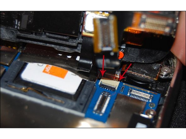

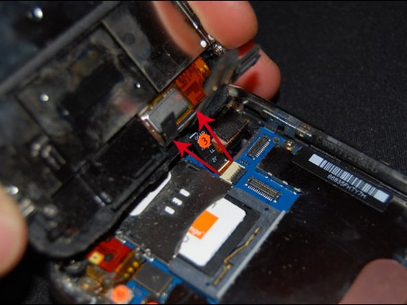

  2. iPhone 3G Glass Replacement, Remove the glass (delicately): crwdns2935265:02crwdnd2935265:01crwdnd2935265:01crwdne2935265:0
    • The glass is gently lifted, the connectors are numbered. The first is removed by itself, the second is easily disengaged using the plastic lever tool.
    • The third connector is a flat sheet that must be removed by sliding it to the top of the phone.

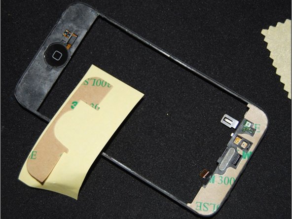

  5. iPhone 3G Glass Replacement, Peel off the window glass: crwdns2935265:05crwdnd2935265:01crwdnd2935265:02crwdne2935265:0 iPhone 3G Glass Replacement, Peel off the window glass: crwdns2935265:05crwdnd2935265:02crwdnd2935265:02crwdne2935265:0
    • We must now take off the glass frame. With a flat screwdriver you will also take care to remove the pieces of tape double-sided. This is a long but important step because a surplus of double-face would create a gap between the screen and the silver turn of the iphone.
