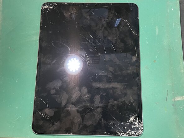

iPad Pro M4 13" Screen Replacement
  1. iPad Pro M4 13" Screen Replacement, Getting Started: crwdns2935265:01crwdnd2935265:01crwdnd2935265:03crwdne2935265:0 iPad Pro M4 13" Screen Replacement, Getting Started: crwdns2935265:01crwdnd2935265:02crwdnd2935265:03crwdne2935265:0 iPad Pro M4 13" Screen Replacement, Getting Started: crwdns2935265:01crwdnd2935265:03crwdnd2935265:03crwdne2935265:0
    • Tools Needed: - Heat mat or Heat Gun - Isopropyl Alcohol - Metal Pry Tool - Plastic opening picks - X-ACTO Knife - Tweezers - PH000 (Philips) + Handle - Adhesive - New OLED Screen Display (OLED + Glass)
    • It’s the first iPad to use OLED-based display modules (both the 11-inch and 13-inch M4 iPad Pros have a “tandem OLED” display).
    • The 13-inch M4 iPad Pro is Apple’s thinnest device ever, at 5.1 mm thick.
    • It’s the first iPad to use the Apple M4 chip.
    • *** Helpful Repair tip - Always look at your NEW part and assess how it's built, where cables are, and what may need to be transferred to your new part. (If you get accustomed to where cables lay on the new screen you can prevent cutting cables.)

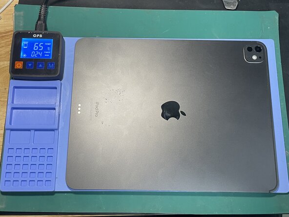

  2. iPad Pro M4 13" Screen Replacement, Heating: crwdns2935265:02crwdnd2935265:01crwdnd2935265:01crwdne2935265:0
    • Place iPad on Heating Pad & allow iPad to heat up to around 75 Degrees Celsius to 80 Degrees Celsius (You mainly are aiming to increase the total temp of the iPad so that all the adhesive releases easier.)
    • *iPad may be hot to the touch. You can wear a long sleeve shirt or use a towel to cover your arm and hands when holding.
