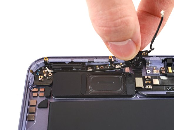

    • Gently peel the volume button board away from the frame to completely separate the adhesive.
  25. iPad Mini 6 Volume Buttons Replacement, Remove the volume button board: crwdns2935265:025crwdnd2935265:01crwdnd2935265:02crwdne2935265:0 iPad Mini 6 Volume Buttons Replacement, Remove the volume button board: crwdns2935265:025crwdnd2935265:02crwdnd2935265:02crwdne2935265:0
    • Use your fingers to remove the volume button board.

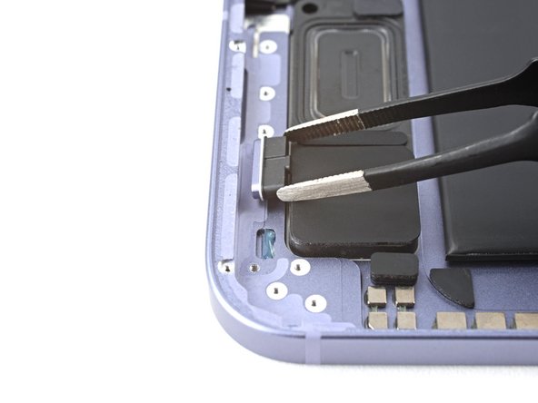

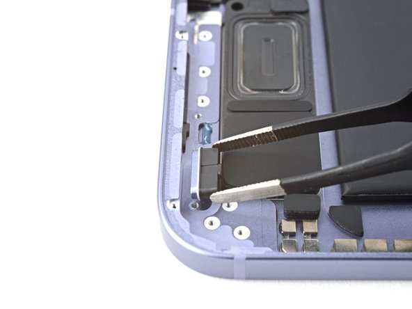

  26. iPad Mini 6 Volume Buttons Replacement, Remove the volume buttons: crwdns2935265:026crwdnd2935265:01crwdnd2935265:03crwdne2935265:0 iPad Mini 6 Volume Buttons Replacement, Remove the volume buttons: crwdns2935265:026crwdnd2935265:02crwdnd2935265:03crwdne2935265:0 iPad Mini 6 Volume Buttons Replacement, Remove the volume buttons: crwdns2935265:026crwdnd2935265:03crwdnd2935265:03crwdne2935265:0
    • Use tweezers, or your fingers, to remove the volume buttons from their slots in the frame.
