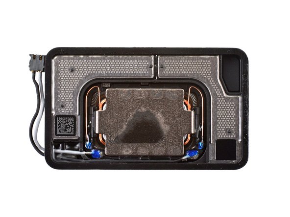

  26. iPad Mini 6 Speaker Assembly Replacement, Remove the top speaker: crwdns2935265:026crwdnd2935265:01crwdnd2935265:03crwdne2935265:0 iPad Mini 6 Speaker Assembly Replacement, Remove the top speaker: crwdns2935265:026crwdnd2935265:02crwdnd2935265:03crwdne2935265:0 iPad Mini 6 Speaker Assembly Replacement, Remove the top speaker: crwdns2935265:026crwdnd2935265:03crwdnd2935265:03crwdne2935265:0
    • At this point, the perimeter of the speaker should be separated from the frame. If there's still resistance around the edges of the speaker, use an opening pick to cut the adhesive again.
    • Pry up with the opening pick to completely separate the top speaker from the frame.
    • Remove the top speaker.

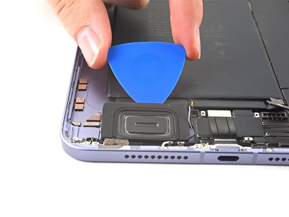

  29. iPad Mini 6 Speaker Assembly Replacement, Bottom speaker information: crwdns2935265:029crwdnd2935265:01crwdnd2935265:02crwdne2935265:0 iPad Mini 6 Speaker Assembly Replacement, Bottom speaker information: crwdns2935265:029crwdnd2935265:02crwdnd2935265:02crwdne2935265:0
    • While you're waiting for the adhesive to loosen, note the following:
    • Adhesive is located around the perimeter of the speaker.
    • Insert a pick 2 mm to separate this adhesive.
    • Adhesive is also located in the center of the speaker.
    • Insert a pick 9 mm to separate this adhesive.

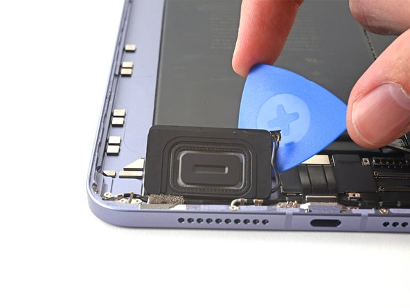

  30. iPad Mini 6 Speaker Assembly Replacement, Separate the bottom speaker's adhesive: crwdns2935265:030crwdnd2935265:01crwdnd2935265:03crwdne2935265:0 iPad Mini 6 Speaker Assembly Replacement, Separate the bottom speaker's adhesive: crwdns2935265:030crwdnd2935265:02crwdnd2935265:03crwdne2935265:0 iPad Mini 6 Speaker Assembly Replacement, Separate the bottom speaker's adhesive: crwdns2935265:030crwdnd2935265:03crwdnd2935265:03crwdne2935265:0
    • Insert an opening pick between the bottom speaker and the frame.
    • Insert the pick at least 9 mm to separate the center adhesive.
  31. iPad Mini 6 Speaker Assembly Replacement: crwdns2935265:031crwdnd2935265:01crwdnd2935265:03crwdne2935265:0 iPad Mini 6 Speaker Assembly Replacement: crwdns2935265:031crwdnd2935265:02crwdnd2935265:03crwdne2935265:0 iPad Mini 6 Speaker Assembly Replacement: crwdns2935265:031crwdnd2935265:03crwdnd2935265:03crwdne2935265:0
    • Slice along the perimeter of the bottom speaker to separate the adhesive.
  32. iPad Mini 6 Speaker Assembly Replacement, Remove the bottom speaker: crwdns2935265:032crwdnd2935265:01crwdnd2935265:03crwdne2935265:0 iPad Mini 6 Speaker Assembly Replacement, Remove the bottom speaker: crwdns2935265:032crwdnd2935265:02crwdnd2935265:03crwdne2935265:0 iPad Mini 6 Speaker Assembly Replacement, Remove the bottom speaker: crwdns2935265:032crwdnd2935265:03crwdnd2935265:03crwdne2935265:0
    • Pry up with the opening pick to completely separate the bottom speaker from the frame.
    • Remove the bottom speaker.
