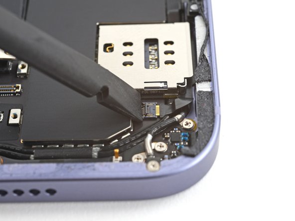

    • Use tweezers, or your fingers, to remove the black tape on top of the SIM card reader's ZIF connector.
  17. iPad Mini 6 SIM Card Reader Replacement, Disconnect the SIM card reader's ZIF connector: crwdns2935265:017crwdnd2935265:01crwdnd2935265:02crwdne2935265:0 iPad Mini 6 SIM Card Reader Replacement, Disconnect the SIM card reader's ZIF connector: crwdns2935265:017crwdnd2935265:02crwdnd2935265:02crwdne2935265:0
    • Use a spudger, an opening tool, or your fingernail to flip up the small, hinged locking flap on the SIM card reader cable's ZIF connector.
  18. iPad Mini 6 SIM Card Reader Replacement: crwdns2935265:018crwdnd2935265:01crwdnd2935265:02crwdne2935265:0 iPad Mini 6 SIM Card Reader Replacement: crwdns2935265:018crwdnd2935265:02crwdnd2935265:02crwdne2935265:0
    • Use a pair of tweezers to pull the SIM card reader cable straight out of its connector on the frame.

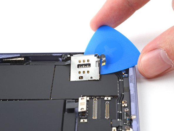

  19. iPad Mini 6 SIM Card Reader Replacement, Separate the SIM card reader's adhesive: crwdns2935265:019crwdnd2935265:01crwdnd2935265:03crwdne2935265:0 iPad Mini 6 SIM Card Reader Replacement, Separate the SIM card reader's adhesive: crwdns2935265:019crwdnd2935265:02crwdnd2935265:03crwdne2935265:0 iPad Mini 6 SIM Card Reader Replacement, Separate the SIM card reader's adhesive: crwdns2935265:019crwdnd2935265:03crwdnd2935265:03crwdne2935265:0
    • Insert an opening pick between the frame and the SIM card reader's edge closest to its ZIF connector.
    • Slice while prying up with the pick around the perimeter of the reader to separate the adhesive.

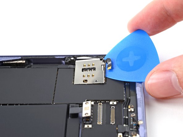

  20. iPad Mini 6 SIM Card Reader Replacement, Remove the SIM card reader: crwdns2935265:020crwdnd2935265:01crwdnd2935265:03crwdne2935265:0 iPad Mini 6 SIM Card Reader Replacement, Remove the SIM card reader: crwdns2935265:020crwdnd2935265:02crwdnd2935265:03crwdne2935265:0 iPad Mini 6 SIM Card Reader Replacement, Remove the SIM card reader: crwdns2935265:020crwdnd2935265:03crwdnd2935265:03crwdne2935265:0
    • Gently peel back the remaining adhesive attached to the SIM card reader.
    • Remove the SIM card reader.
