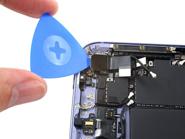

  22. iPad Mini 6 Rear Camera Replacement, Heat the rear camera: crwdns2935265:022crwdnd2935265:01crwdnd2935265:01crwdne2935265:0
    • Apply a heated iOpener to the top-right edge of the device for 1–2 minutes to loosen the rear camera's adhesive underneath.
    • A hair dryer, heat gun, or hot plate may also be used, but be careful not to overheat the device.
  23. iPad Mini 6 Rear Camera Replacement, Separate the rear camera's adhesive: crwdns2935265:023crwdnd2935265:01crwdnd2935265:03crwdne2935265:0 iPad Mini 6 Rear Camera Replacement, Separate the rear camera's adhesive: crwdns2935265:023crwdnd2935265:02crwdnd2935265:03crwdne2935265:0 iPad Mini 6 Rear Camera Replacement, Separate the rear camera's adhesive: crwdns2935265:023crwdnd2935265:03crwdnd2935265:03crwdne2935265:0
    • Insert an opening pick between the rear camera and the frame.
    • Rotate the pick around the perimeter of the camera to separate all of the adhesive.
  24. iPad Mini 6 Rear Camera Replacement: crwdns2935265:024crwdnd2935265:01crwdnd2935265:02crwdne2935265:0 iPad Mini 6 Rear Camera Replacement: crwdns2935265:024crwdnd2935265:02crwdnd2935265:02crwdne2935265:0
    • Pry up with the opening pick to fully separate the rear camera from the frame.
    • If you're having trouble separating the adhesive, reapply the iOpener for 1–2 minutes and try again.
  25. iPad Mini 6 Rear Camera Replacement, Remove the rear camera: crwdns2935265:025crwdnd2935265:01crwdnd2935265:01crwdne2935265:0
    • Use tweezers, or your fingers, to remove the rear camera.
