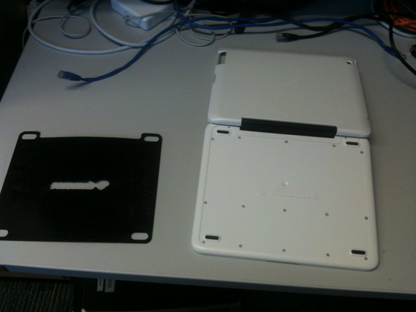

      • You can skip the first 2 steps if you don't want to detach the upper and keyboard covers from each other.
      • Open the case and unpeel the 2 black stickers in the top corners of the keyboard.
      • This will reveal the 6 screws that attach the upper cover to the keyboard cover.
    2. iPad ClamCase: crwdns2935265:02crwdnd2935265:01crwdnd2935265:02crwdne2935265:0 iPad ClamCase: crwdns2935265:02crwdnd2935265:02crwdnd2935265:02crwdne2935265:0
      • Use the T9 Torx screwdriver to unscrew the 2 bigger screws in the middle of each side.
      • Use the T6 Torx screwdriver to unscrew the remaining 4 screws.
    3. iPad ClamCase: crwdns2935265:03crwdnd2935265:01crwdnd2935265:02crwdne2935265:0 iPad ClamCase: crwdns2935265:03crwdnd2935265:02crwdnd2935265:02crwdne2935265:0
      • Turn the keyboard cover over so the bottom is facing up. Manually remove the thin black covering that is attached to the bottom.
      • Be patient, the thin black covering might be really stuck to the bottom.
    4. iPad ClamCase: crwdns2935265:04crwdnd2935265:01crwdnd2935265:01crwdne2935265:0
      • Once the thin black covering is removed, you will see 15 screws.
      • Use the T6 Torx screwdriver to remove the screws.
    5. iPad ClamCase: crwdns2935265:05crwdnd2935265:01crwdnd2935265:01crwdne2935265:0
      • Once the screws are removed, lift off the bottom panel to access the keyboard and battery.
    6. iPad ClamCase: crwdns2935265:06crwdnd2935265:01crwdnd2935265:01crwdne2935265:0
      • You are done.

Awesome! I used this guide to disassemble my clam case and repair some nonfunctional keys. Thanks!
justin duff - crwdns2934203:0crwdne2934203:0 crwdns2950251:0crwdne2950251:0
Thanks for the dis-assembly guide. Justin, what did you have to do to fix the keys that were not working. I have on with a few keys not working, not even intermittently.
dick haynes - crwdns2934203:0crwdne2934203:0 crwdns2950251:0crwdne2950251:0
