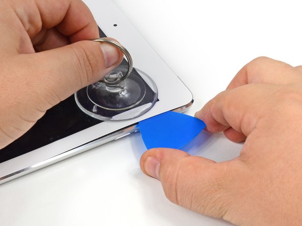

    • Pop pop! Oh the glorious sound of an iPad popping open, with a mysterious coin for mysterious scale.
    • A twenty-cent coin! They don't have those in the U.S.!
    • You're right, astute teardown reader! That is, in fact, an Australian coin. If you hadn't noticed, this whole teardown has been upside-down, courtesy of our favorite minion Walter, who survived the arduous trek down under.
    • Alright, enough clowning around! It's time to open this iPad up (like a book of scary stories).

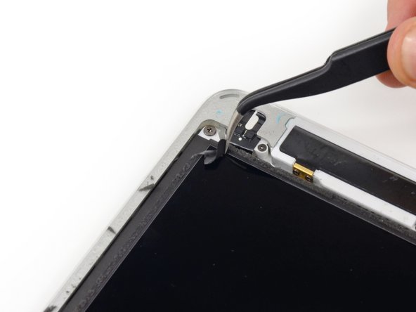

    • For our next trick, we magic away the front-facing camera. You'll have to take your costume pics the old fashioned way.
    • Ho, hum: The 1.2-megapixel, 720p FaceTime camera fails to send any shivers down our spine.

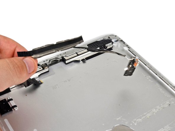

    • What's this? We carve the headphone jack(-o-lantern) out.
    • Catch these cell antennas while you can—you won't find them in the strictly Wi-Fi version. They're a huge phone exclusive.

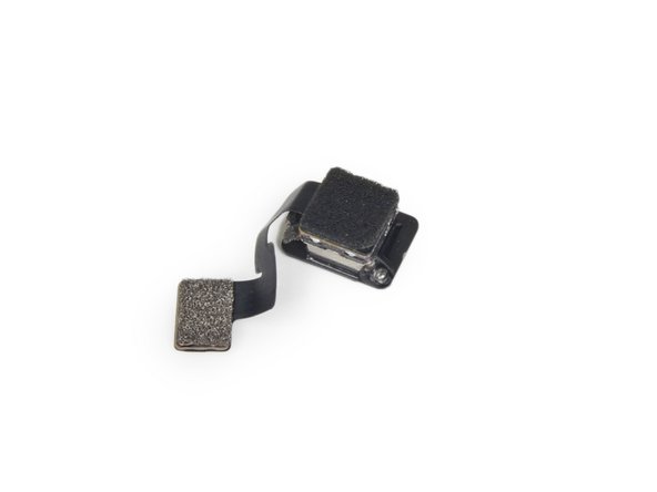

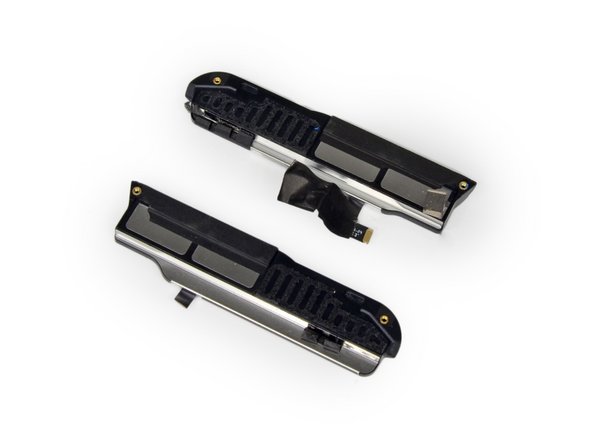

    • A quick 180º, and the speakers become our next victim. Shrouded in mystery, Apple calls these speakers "built-in," opting to leave the maker unspecified.

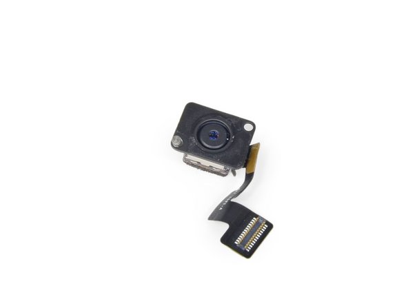

    • We're bobbing for apples!
    • Sticking our spudger in for a dunk, we come up with another camera. This time it is the 5MP rear-facing camera.
