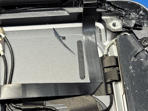

    • While the iPad looks uniform from the outside, there are delicate components, such as flex cables, under the front glass. To avoid damage, only heat and pry in the areas described in each step.
    • As you follow the directions, take special care to avoid prying in the following areas:
    • Front-facing camera
    • Antennas
    • Display Cables

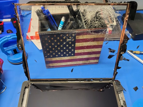

  4. iPad 7 Cracked Digitizer Replacement: crwdns2935265:04crwdnd2935265:01crwdnd2935265:02crwdne2935265:0 iPad 7 Cracked Digitizer Replacement: crwdns2935265:04crwdnd2935265:02crwdnd2935265:02crwdne2935265:0
    • Repeat Step 3 until the digitizer is free from the frame.
    • Don't attempt to remove the digitizer just yet. It is still connected to the main board with 3 different flex cables
    • Lift the left side of the digitizer towards the right side and lean it against something to keep it upright.
    • This will allow you to get to the LCD screen and proceed with the repair.

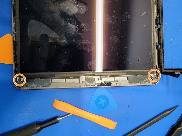

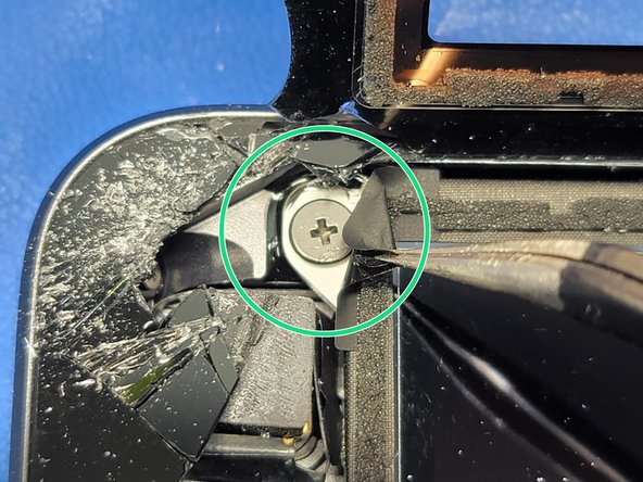

    • Locate the four screws holding down the LCD screen. These will be locate on all four corners of the LCD screen
    • Two screws are under a little piece of adhesive. Just lift the adhesive used ESD safe tweezers.
    • The other two screws are not covered
    • Don't remove that adhesive as it may cause damage to the LCD screen
    • Make sure to carefully clear any remaining digitizer glass away from the LCD screen to allow for it to lift without scratching

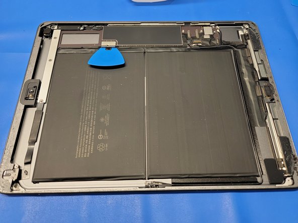

  7. iPad 7 Cracked Digitizer Replacement, Battery Isolation: crwdns2935265:07crwdnd2935265:01crwdnd2935265:02crwdne2935265:0 iPad 7 Cracked Digitizer Replacement, Battery Isolation: crwdns2935265:07crwdnd2935265:02crwdnd2935265:02crwdne2935265:0
    Battery Blocker
    $3.99
    • Locate the battery connector
    • Remove the 2.4mm screw securing the battery connector down to the mainboard
    • Insert the battery blocker STRAIGHT IN to lift the FPC connector from the battery.
    • Make sure to insert the battery blocker STRAIGHT IN. When removing, make sure the pull the battery blocker STRAIGHT OUT.
    • If you decide to not use the battery blocker, make sure to wear ESD gloves, and to use ESD safe tools. Only use metal tools when absolutely required (ex: screwdriver for screws)

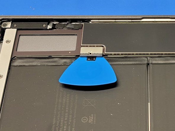

  8. iPad 7 Cracked Digitizer Replacement: crwdns2935265:08crwdnd2935265:01crwdnd2935265:01crwdne2935265:0
    • Locate this metal bracket that holds down the digitizer and LCD panel flex cables
    • Remove all three 1.4mm screws and remove bracket using ESD safe tweezers
    • Make sure to use ESD rated tools even if you use the battery blocker. This way you limit your chance of shorting out the board.
    • Before securing this bracket onto the main board, make sure to test all functionality of the iPad. This will allow for faster disconnecting and reconnecting of flex cables if troubleshooting is required.

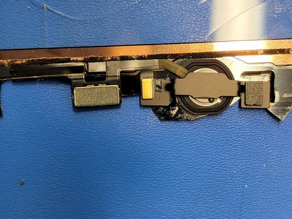

    • Locate the noise bumper that helps secure the home button flex cable to the frame
    • Use the Halberd Spudger to gently lift the bumper off the cable and frame
    • No heat should be necessary. But if you feel safer applying heat, only apply a small amount, as there is only a small amount of adhesive
    • Be sure NOT to rip the flex cable. This can cause irreparable damage to the home button and cause TOUCH ID to not work

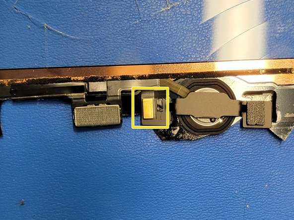

    • Locate the home button flex cable and follow it to its connector
    • You will notice there is a bit of tape covering this connector
    • Gently remove this adhesive using ESD safe tweezers
    • Make sure to ONLY grab the adhesive and not the cable, connector, port, or main board

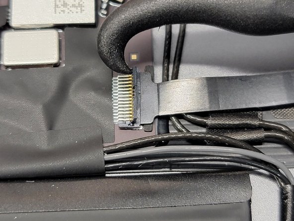

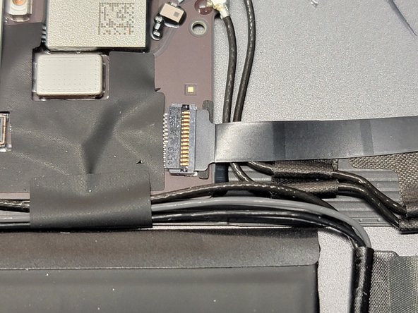

    • Take the hook end of the Halberd Spudger and place right in between the black flap and the metal connectors
    • Gently pull up and down towards the bottom of the iPad (right in the picture), making sure not to use much force
    • Use ESD safe tweezers to gently grab and pull out the cable towards the bottom of the iPad (right of the picture)
    • THIS DOES NOT REQUIRE MUCH FORCE. Make sure to not grab, bend, or pull the metal connectors as this may cause more damage and would require microsoldering.

    • On the digitizer, locate the home button on the bottom of the iPad.
    • You will notice a few things we will be detaching from the digitizer
    • Home button bracket and gasket
    • Flex cable

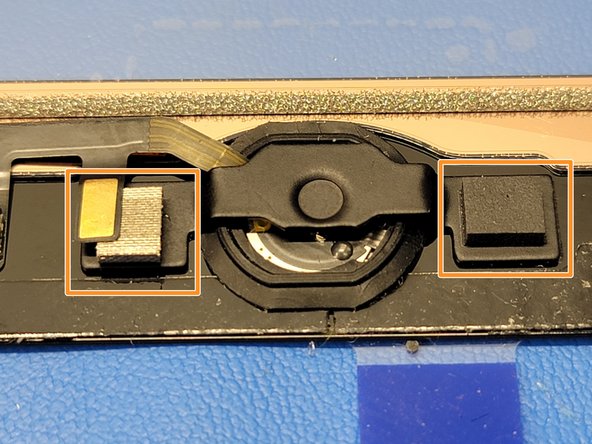

    • On the left side of the home button bracket you will notice a cushion that is on the top of part of the flex cable. We will be removing that
    • Apply a little heat (about 3-7 seconds worth of a hot air blower) to the front of the digitizer where this cushion is located.
    • Use the cutting side of the Halberd Spudger and gently seperate the cushion from the cable and bracket
    • Be careful as the flex cable in in-between the bracket and cushion. Don't lift the flex cable off the bracket just yet

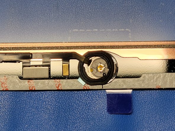

    • Take the cutting side of the Halberd Spudger and place it in-between the flex cable and digitizer.
    • Gently separate the flex cable from the digitizer by bringing the spudger towards the home button
    • Heat shouldn't be required but may help loosen the adhesive if you are finding it a bit difficult to separate the flex cable from the digitizer
    • Once the spudger is near the part of the cable that rested on the bracket, pause. Adjust the spudger so that way you can now separate the flex cable from the bracket without damaging the flex cable
    • Be careful not to tug, twist, tear, or otherwise break the flex cable to the home button. Again, this will cause irreparable damage to the touch ID and home button.

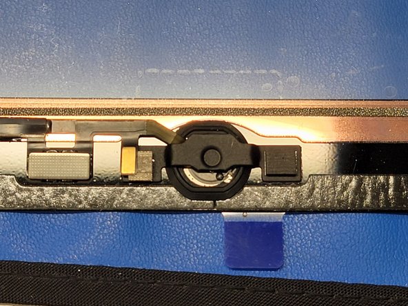

    • Once the flex cable is free from the bracket, you may now remove the metal bracket.
    • This may require a bit of force and heat. Apply about 3-6 seconds worth of heat to the front of the digitizer about 3-5 in away from the digitizer.
    • Take the cutting end of the Halberd Spudger and separate the bracket from the digitizer
    • Again, be careful not to rip, tear, or otherwise break the home button flex cable. This will cause irreparable damage to the touch ID function and home button.
    • Once the bracket is removed, either throw it away or keep it for the new digitizer.
    • Depending where you get the new digitizer will determine if it comes with a new bracket and gasket. If your new digitizer doesn't, simply apply some Tesa tape or glue to the bottom of the bracket, and apply it to the new digitizer after installing the home button. Make sure it is not loose as this could cause home button clicking issues.

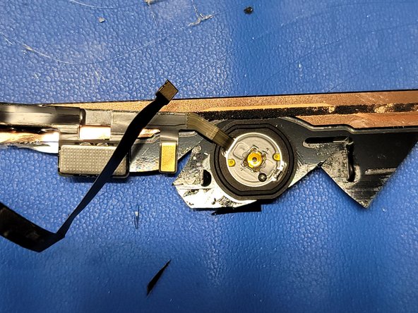

  19. iPad 7 Cracked Digitizer Replacement: crwdns2935265:019crwdnd2935265:01crwdnd2935265:01crwdne2935265:0

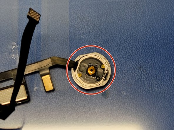

    • Time to remove the home button entirely from the digitizer
    • Apply about 4-7 seconds worth of heat to the front of the digitizer where the home button gasket is.
    • Gently press the home button from the front if the digitizer. With the adhesive being softened by the adhesive, you should be able to gently press the home button off from the digitizer.
    • If you need to reuse the gasket, make sure to be extra gentle and be generous with the heat as the gasket can easily be torn.

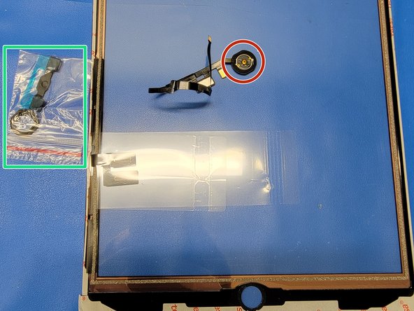

  22. iPad 7 Cracked Digitizer Replacement, New Digitizer: crwdns2935265:022crwdnd2935265:01crwdnd2935265:03crwdne2935265:0 iPad 7 Cracked Digitizer Replacement, New Digitizer: crwdns2935265:022crwdnd2935265:02crwdnd2935265:03crwdne2935265:0 iPad 7 Cracked Digitizer Replacement, New Digitizer: crwdns2935265:022crwdnd2935265:03crwdnd2935265:03crwdne2935265:0
    • Gather your new home button bracket, gasket
    • VERY CAREFULLY remove old gasket from home button. We use ESD tweezers to do this very slowly and accurately as to not break the home button
    • If you don't have a replacement gasket, don't worry. Don't remove gasket from home button. Instead you will use new tesa tape or a bit of glue to adhere the gasket to the new digitizer
    • While doing this, make sure to not rip, tear, or otherwise break the home button flex cable. This will cause irreparable damage to the touch ID and home button
  23. iPad 7 Cracked Digitizer Replacement: crwdns2935265:023crwdnd2935265:01crwdnd2935265:02crwdne2935265:0 iPad 7 Cracked Digitizer Replacement: crwdns2935265:023crwdnd2935265:02crwdnd2935265:02crwdne2935265:0
    • Take the new gasket and look at it closely. There should be 2 rings of adhesive on it being covered up by blue strips of plastic. You will also notice there are 2 notches on thw inner portion of the gasket. This will help guide you with installing the new gasket
    • Insert the home button perpendicular to the gasket making sure to have it go through the 2 inner notches of the gasket and having the blue adhesives strips towards the part of the button where your finger clicks.
    • Once the gasket is on the home button but not applied, we need to apply the gasket.
    • One notch of the inner part of the gasket will go where the flex cable meets the home button.
    • When you remove the inside ring blue plastic, that adhesive is suppose to adhere to the home button.
    • Remove the inner most blue plastic by using ESD safe tweezers and an xacto knife. You will use the xacto knife to CAREFULLY cut a notch on the blue plastic so that way you can remove it easily from the home button.
    • Lift the home button up and use ESD safe tweezers remove the outermost blue plastic. Since the gasket is applied to the home button now, the outer blue plastic should come right off without the need to cut. Place the home button inside the hole of the digitizer. Once you are confident it is in the right position, firmly press down on the gasket.
    • Place the home button in the hole of the digitizer, and angle the flex cable towards the left of the digitizer (the side where the digitizer flex cables are).

    • Take the metal bracket and remove the white paper covering the adhesive on the cushion
    • Take the blue plastic off the metal bracket
    • If reusing old bracket, take tesa tape or glue and apply a little amount to both ends where the bracket will adhere to the digitizer
    • Align the bracket with the cushion to the left and the indent on the bracket in the center of the home button.
    • Make sure to lift the flex cable gently over the metal bracket before pressing down
    • Once aligned, and flex cable is placed in the correct position over the bracket, firmly but gently press the 2 sides of the bracket onto the digitizer.
