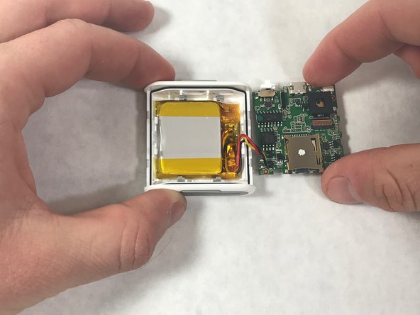

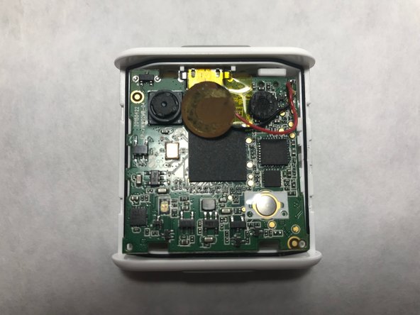

  5. iON SnapCam 1046 Lite Battery Replacement, Battery: crwdns2935265:05crwdnd2935265:01crwdnd2935265:02crwdne2935265:0 iON SnapCam 1046 Lite Battery Replacement, Battery: crwdns2935265:05crwdnd2935265:02crwdnd2935265:02crwdne2935265:0
    • Use a nylon spudger to gently pry the four tabs holding the motherboard in place.
  6. iON SnapCam 1046 Lite Battery Replacement: crwdns2935265:06crwdnd2935265:01crwdnd2935265:02crwdne2935265:0 iON SnapCam 1046 Lite Battery Replacement: crwdns2935265:06crwdnd2935265:02crwdnd2935265:02crwdne2935265:0
    • Lift the motherboard to reveal the battery compartment. Remove the thermal tape holding it in place and replace battery.
    • WARNING: Lithium Battery!
